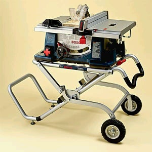

Tablesaw-this is for accurately ripping boards to size and for cutting joints.

Once you have the measurements recorded its time to cut and rip all of the boards. You will want to select from your lumber how your cuts should be taken from each piece. Meaning, try not waste any of that expensive wood and try to visually find all the flawed places so they can be cut out. Next, use the miter saw to cut each piece out. Take the time to label each piece for placement, direction, and also inside or outside. One last thing, BE SURE TO ADD AN EXTRA 2 INCHES TO THE HORIZONTAL BOARDS!!!!! This will guarantee you don't come up short on length from cutting the tongue of the joints!! Last, be sure to save all of the left over scraps.......they come in handy!
Now you can start ripping the piece widths. Set up your table saw to cut against the rip fence ( this is the adjustable guide that runs parallel with the saw blade) and cut your pieces. Being that some of the pieces have different widths, you will be moving the rip fence constantly. I would suggest taking your time and cutting all the like pieces at the same time before moving the fence again. This ensures that all like cuts are more consistent.
