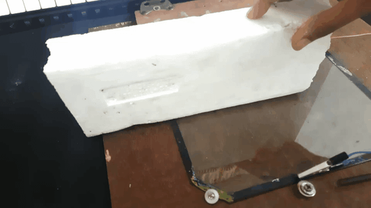

If you’re planning to use thermocol sheets to build your RC plane like I did, you’ll need to set up a jig with nichrome wire to cut 3mm thin sheets from the bulk thermocol. However, if you’re using Depron sheets, you can skip this hassle entirely.

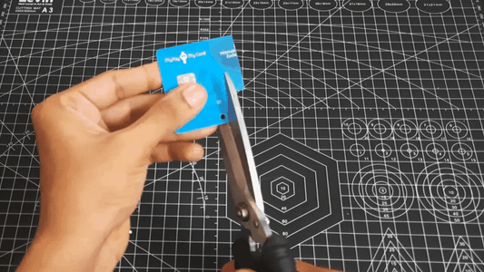

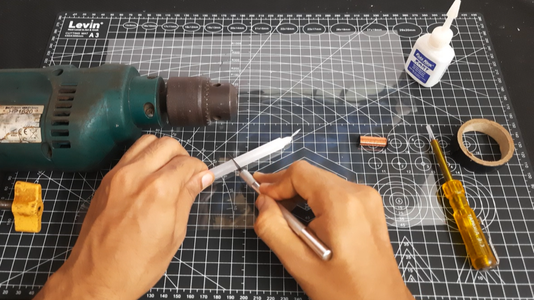

Step 1: Magnetic Actuator Part 1
We'll begin by building the actuator for our RC plane. First, I’m cutting the moving part of the actuator from a PVC card, then gluing a 3mm neodymium magnet into the pre-drilled holes.

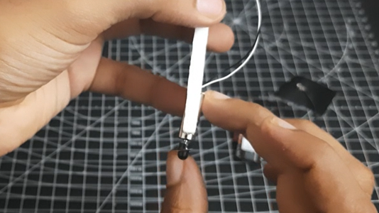

Step 2: Magnetic Actuator Part 2
Now, we’ll be making the coil for the magnetic actuator. I’m using a 10mm candle as a guide to wind it. For a better understanding, check out the detailed video included in this step.

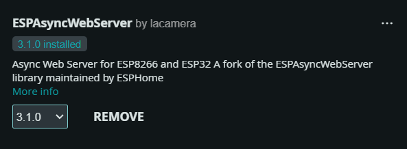

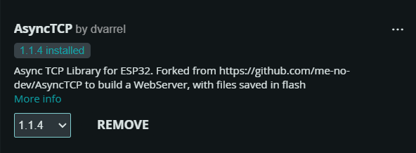

Step 4: Libraries to Install
Required Libraries: AsyncTCP, ESPAsyncWebServer

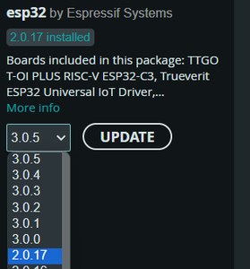

Before uploading the code, ensure these libraries are installed. Also, make sure to install only version 2.0.17 of the ESP32 board by Espressif Systems, as using a newer version may cause compilation issues with the code I provided in the below step.
Step 5: Uploading the Code
After installing the necessary libraries, copy the code below and upload it to the ESP32-C3 board using the Arduino IDE.

With all the electronic components ready, you can now build any RC plane design you envision. Here, I’m creating a simple Cessna-style RC plane. Using the provided PDF template, cut out the necessary parts for your plane. Since I used thermocol, I first set up a jig to slice 3mm sheets from the bulk material. I’d recommend using Depron sheets or applying a suitable coating to strengthen the thermocol, as it’s quite fragile and prone to breaking. Then, I used an emery paper to smooth the rough edges and tapered the wing trailing edges to improve it's aerodynamics.

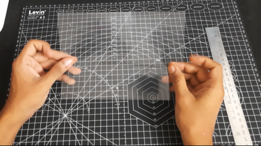

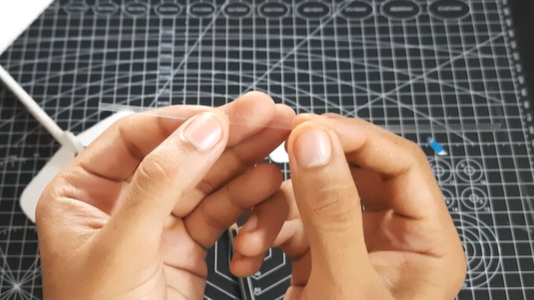

Step 9: Mounting the Control Surfaces
To mount the control surfaces, I cut 1.5mm-wide strips from a 100-micron thick OHP sheet and used them to attach the rudder and elevator to the RC plane’s frame with glue as shown in the above GIFs / Images.

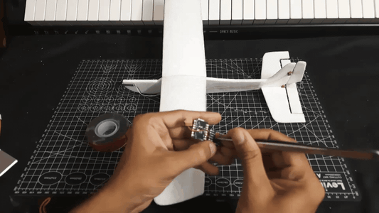

Step 11: Final Setup
With the frame complete, all that’s left is to attach the electronic components and solder the necessary connections. I attached the components to the frame using double-sided tape, though a hot glue gun is also a great option for securing them. Ensure you position the lithium-ion battery on the frame so that the plane balances slightly nose-down when held 1/4 to 1/3 of the way back from the wing’s leading edge.
