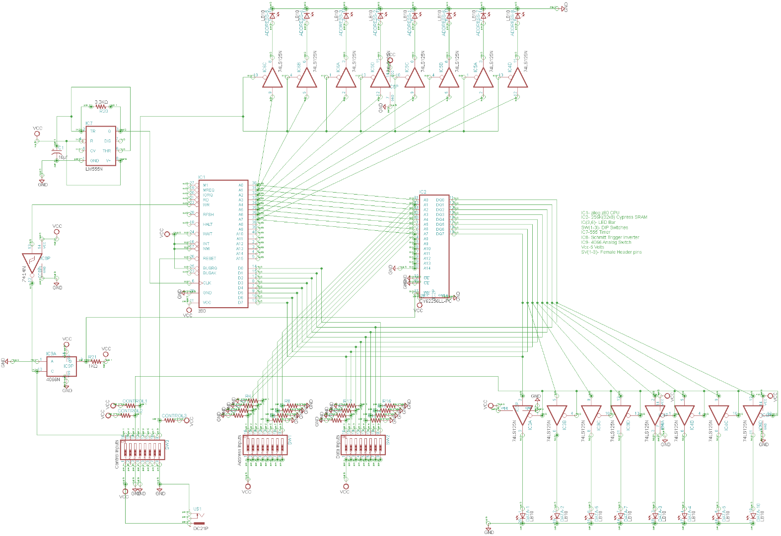

Step 1: Step 2: Get Your Design!
I got my design from a variety of resources. This is an extremely simplified version that I found after looking at kits on http://cpuville.com/computer_details.html and emailing its creator. He guided me and showed me a simple starter z80 circuit diagram that I could use to learn from. I had also been reading from Steve Ciarcia's book Build your own z80 to get inspiration ( It is available on google books for free! Check it out!) . Utilizing his basic design I also added a few other details (after breadboard experimentation, that's step 3 :P) like a RAM programmer, and some displays.

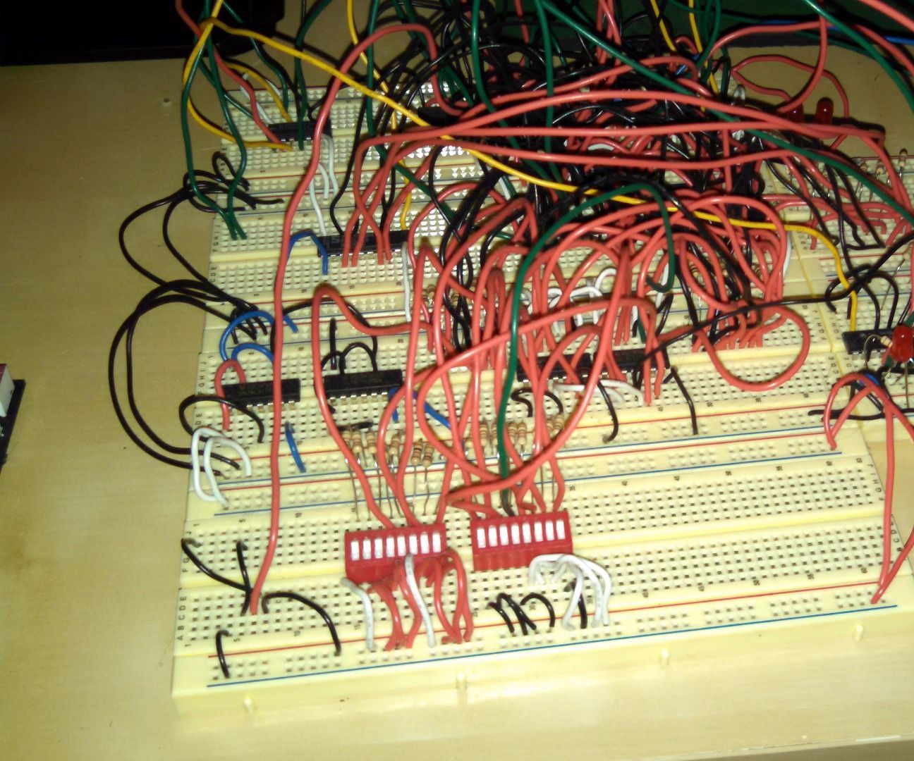

Step 2: Step 3: Do a Quick Breadboard Run!
This step is optional but highly recommended. It will be very educational if you run through the whole circuit first, that way you can learn all the ins and outs of how your computer calculates

Step 5: Step 6: Now Make Your PCB!
I used Eagle CAD software for this, as it is free and easy to use. I definitely suggest it as there are many tutorials available for it all over the internet, so I will not go to in depth in its usage here. Take your schematic and create how you want your PCB to look! Lay out is all up to you so have fun! I used the auto routing tool because there are many connections, but I did try my best to check it all. Now save that and etch your board! I sent mine to a board house to be etched as I am not experienced in that, but if you are by all means go for it.
