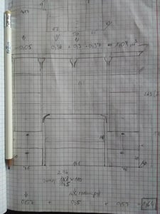

I made a quick drawing to have it at hand for the upper part.
cut your vertical parts to size, lay in order next to each other, and mark your shelv supporter. At the end it should be quite horizontal, thatswhy I laid them in pairs, aligned the bottom, and marked together.
