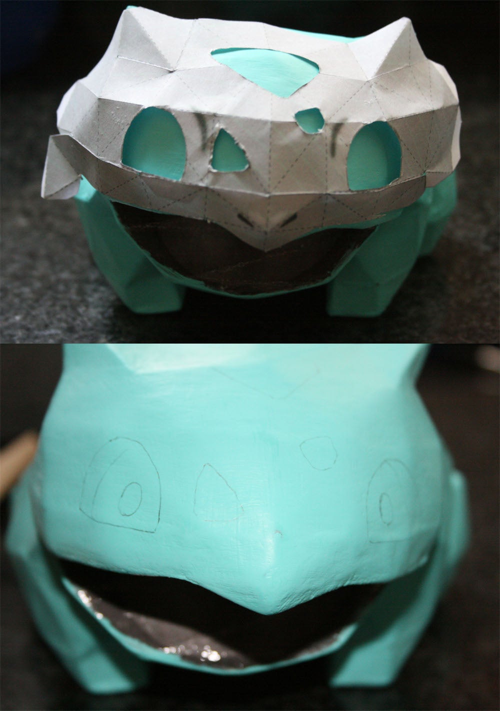

I started painting the base color. In the begining I tried to avoid painting the spots and the eyes, so that I could have a reference for when I painted them, but it was not comfortable to paint it like that. I decided to paint it all with the base color and then printed and assembled the face again to make a stencil out of it.
When I sanded the base color to have a smoother surface and while working on the Bulbasaur, I got some flaws (as you can see in the third picture). I used the spots to cover these flaws (note that I drew the spots around the flaws). The new spots are not placed exactly in the same place as the original ones, but I tried to make an homogeneous distribution.
