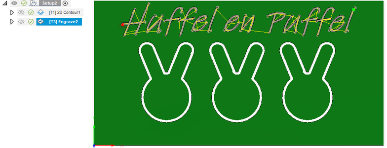

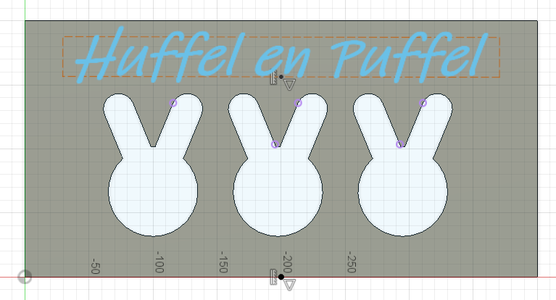

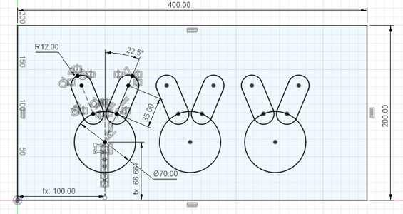

Step 3: CnC Routing
Using a CnC router, cut out the bunny heads and engrave the desired name(s) in the 40x20 piece of plywood. For expanded instructions on using a CnC router, you can check out other guides on instructables. A .dxf of the bunny heads is attached and shown in the Fusion 360 screenshot. The bunny heads are carved out using a 2D contour toolpath and the names using an engraving toolpath, both executed using a 3.175 mm square end mill.
