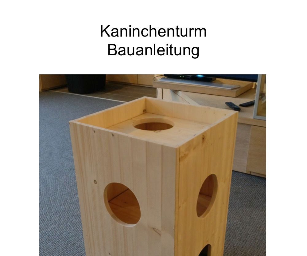

I never liked the houses that you can buy in pet stores, so I made up my own! I don't have a lot experience in working with wood, I bet you could do this more elegantly, this is just my approach =) It is very easy to do and you could even do it in one day!
Have fun bunny lovers!

When you are done with sawing, sanding the edges and having attached the wooden strips, you connect all
4 sides with the metal brackets. It should look like this from above.
ATTENTION! Depending in the length of the wooden strips it might not be possible to insert the first floor,
after you have connected all 4 walls. It is better to put in the first floor, before fixing the 4th wall. However, if you work with the same dimensions as I did, you will be able to insert the floor even after you have connected all 4 walls.
