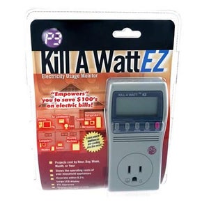

Suggested supplies are a multimeter, preferably a clamp-on ammeter, a watt-hour meter (measures variable loads), love.

For refrigerators and similar intermittent loads, use a watt-hour meter such as a Kill-a-Watt to measure the device's total electrical use over a day or so.

Look at your electrical budget. Now measure your actual loads and look for discrepancies. Say you budgeted 100 watts but your load is actually 300W. What's happening?
Measure with your watt hour meter starting from your electrical source and work your way down the distribution chain until you find your vampire. Is there something plugged into the end of your Christmas lights? Did a set of incandescent Christmas lights sneak into your collection? Is there a toaster or coffee maker drinking all your electrons? Here’s an example: https://youtu.be/UuzDqsP2Tyk
