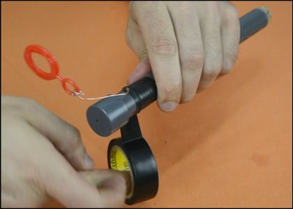

Cut off the bottom of the container.
Step 3:
Glue it on a plastic pipe.
Step 4:
Drill a hole in the cap.
Don't drill it too big. You can make it bigger later. (if necessary)
Put the cap onto the pipe.
Attach the wire around the pipe.
Step 5:
Cut off the ring from the bubble wand and attach it to the other end of the wire.
You can wrap the wire with electrical tape if necessary.
Step 6:
Your gas bubble attachment for the butane canister is ready.
