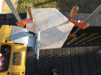

The formwork for the base is the most complex part of the lamp. Start by tracing the 8" sonotube (cardboard tube concrete formwork for setting piers and posts) onto the plywood.
On two of the circles, lay out eight center points in a radial pattern. Start by pulling one line across the circle, dividing it in two; then measure the center of that line. Take a square and pull a line perpendicular to the first, dividing the circle into four equal pieces. Subdivide again, just like cutting a pie, to create eight even pieces. Measure up each line 2-1/2" from the center and make a mark. Drill each mark with a 1-1/2" bit. Make two identical pieces like this. On one of them, drill out the center with the 2-1/4" hole saw bit.
Cut the two drilled-out circles out of the piece of plywood they are in. Cut them large, so they will rest on top of the sonotube without falling in. Cut the third small, so it will fit inside the sonotube.

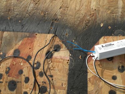

Start by removing the fixture from its metal housing, so it is just a ballast with two sockets wired to it.
Take the plug created by hole-sawing the formwork and sand it down until it can fit inside the PVC pipe. Cut the wires leading from the ballast to one socket end of the fixture and screw that fixture to the plug of wood. Drill two holes in the wood to feed the wires through. Re-attach the socket to the ballast leads with about three or four inches of wire between them. Tape up the wires.
Next, take the power cord (it must be a three-prong grounded cord) and wire the two power leads, white and black, to the power leads coming from the ballast. Fluorescent fixtures must be grounded to work; typically, in hard-wired installation, the ground cord is just attached the metal bulb housing. In this case, since we've discarded the housing, the ground can just be wired directly to the ballast itself. Run the green ground from the power cord up and attach it to one of the mounting holes on the ballast.

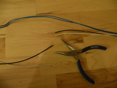

Cut the other socket off and re-wire the two leads with about four feet of black speaker wire or similar. Feed those wires through the wire holes in the wood plug. Tape off and paint the plug white if so desired.
Wrap everything up tight and test the bulb to make sure the wiring is right. Tape the wires to the ballast to make a compact package. Stuff the ballast and wires into the pipe, then push the plug in after. It should fit really tightly; if it won't go in, put the handles of some pliers on the wood and hit the head of the pliers with a hammer. Secure it with a screw or two.

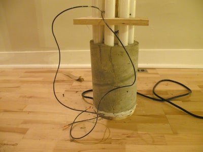

Mix up some concrete in a bucket, fairly stiff. I used a quick-set mix -- Quickrete brand, comes in a red bag -- about forty pounds worth. The quickset stuff allows the concrete to cure up in about thirty minutes, giving your tubes and formwork less time to shift or get wonky on you.
Fill the sonotube to within about an inch of the top, taking care not to slop concrete on the the socket or exposed wires. Place the barbell on the cinderblocks, hovering over the formwork. Align the center of the barbell and the center of the formwork visually. Push the fluorescent tubes through the holes in the barbell, down into the concrete, one by one. Let cure.
After a few hours, strip the formwork with a putty knife and screw gun. This is where I broke a tube; be extremely careful in handling the structure at this point. To get the bottom off, you need to tip the lamp on its side. In doing so, it rolled, and one of the tubes that was slightly out of vertical got pinned against the floor and broke.
Because all the tubes were not perfectly in line -- the plywood pieces with the holes were slightly twisted relative to one another -- the plywood was very difficult to get off. Amazingly enough, I was able to saw it out without breaking any tubes.
