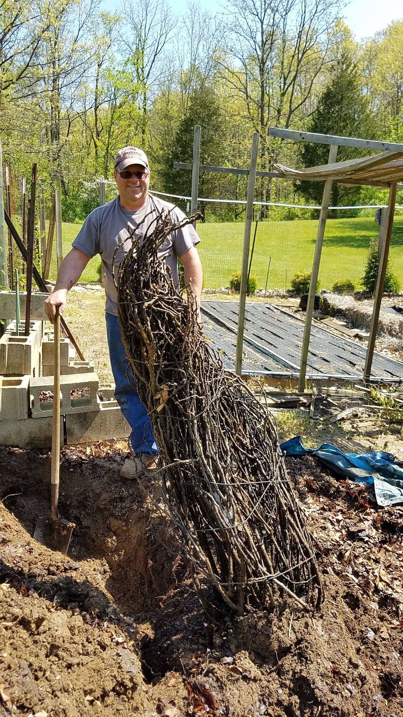

Step 3: Dig a Trench
The trench needs to be long enough and wide enough for the tree to lay into. The top is more critical to get all the way into the trench. Dig down at least 18"-20". The frost line is much deeper around here, so it will stay frozen in the dirt.
Step 4: Dig Around the Front and Back, But Not the Sides
The objective is to lay the tree down without severing all the roots. when you dig, put the shovel in so you don't cut all of the roots. Undercut the front - facing the trench - so the root ball will pivot into the trench.
Step 5: Lay the Tree Into the Trench
Tackle it from the back and push it into the trench.
Step 6: Arrange the Top
Make sure the tops are solidly into the bottom of the trench.
