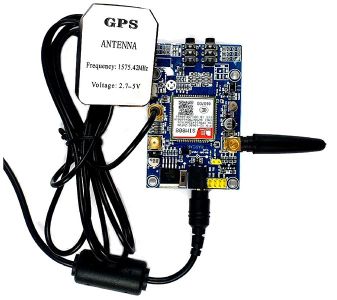

GSM module: A GSM modem or GSM module is a hardware device that uses GSM mobile telephone technology to provide a data link to a remote network. From the view of the mobile phone network, they are essentially identical to an ordinary mobile phone, including the need for a SIM to identify themselves to the network.
Jumper wires: A jump wire is an electrical wire, or group of them in a cable, with a connector or pin at each end which is normally used to interconnect the components of a breadboard or other prototype or test circuit, internally or with other equipment or components, without soldering.
GPS tracker : GPS is a system of 30+ navigation satellites circling Earth. We know where they are because they constantly send out signals. A GPS receiver in your phone listens for these signals. Once the receiver calculates its distance from four or more GPS satellites, it can figure out where you are.

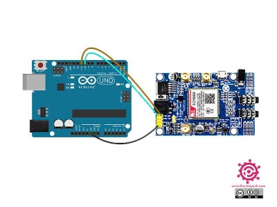

Give the connections as per the circuit shown in the diagram. connect the Arduino NANO pin D10 to TXD of GSM. Connect Arduino NANO pin D11 to RXD of GSM . connect GND of Arduino NANO pin to GND of GSM module. Now upload the code into the Arduino NANO. Install Tinygps library in the Arduino. Connect Antenna pin to Antenna.Connect the Arduino NANO to the laptop and do check the port that is displayed in the screen. Next, open the serial monitor in the Arduino. According to the code we have to send the message as 'HELLOGPS' to the number where the SIM is fixed in the GSM Module .Now we will get the reply as the URL link to us by opening it we can know the exact location of the bus.
