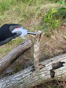

Use the saw to cut 3 pieces of wood.
One around 6” long and smaller that 1” diameter to use in the eye of the auger
One around 12” long and 1”-1.25” diameter to make the handle. You want it to be as straight and consistent as possible.
One around 18” long and 1.5”-2” diameter to use as a “hammer”.
