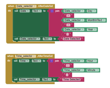

Step 1: Code for Bus Pick Up Time, Date and Time
The date scheduled block allows for people using the app to write in what day they would like to be picked up
to code for the DATE scheduled block :
-switch from design to blocks
-scroll down on the blocks bar and select date_selector under horizontalarrangement1, and choose the option that reads .afterdateset
-scroll to date under vertical arrangement, and under that choose date-text and click and drag it into the afterdateset block
-under built in, choose the text button next to the pink block and choose join to fit into date-text
-to fill in the join block alternate under date sector and texts using date_selector-day, monthintext, year, ¨-¨ and, ¨ ¨
-click and drag ¨set date selector text¨ into the block and compliment it with ¨date selected¨
The time schedule blocks allows for people to specify what time on the day they would like to be picked up
to code for the TIME scheduled block:
-click and drag .aftertimeset from date_selector and create a new separate block
-click and drag time-text from time under vertical arrangement into aftertimeset block -click and drag same join block into time-text block
-alternate between time_slector hour & minute with text ¨:¨, and ¨ ¨ in between
-click and drag ¨set time selector text¨ into the block and compliment with ¨time selected¨

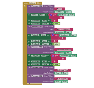

Step 3: Code Block to Store Persons Name, Pick-up & Drop-off Location, Date and Time
This block will function to store all of the inputted information by app users into firebase!
To code for this block:
-use blocks according to the photo, and remember to use firebase db1 as that is how the information is stored, and be sure to type in correct names for every label you're going to use

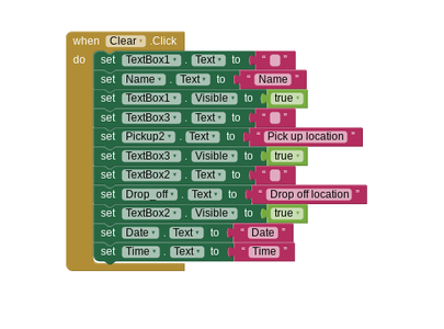

Step 4: Code to Clear All Entered Data
This block will code so that when a person using the app presses the button clear, all of the entered data will be removed from their respective text boxes and returned to how they were before
To code for the clearing block:
1. scroll down on left sidebar and click on clear under horizantalarrangement5, and from that click and drag ¨when clear .click¨ onto your screen and create a new block
2. under horizontalarrangement3 click and drag ¨set textbox1 text¨ from textbox1 into new block & compliment with " ¨ from text
3. click and drag ¨set name text¨ directly underneath ¨textbox1¨ block, compliment with ¨name¨ from text
4. click and drag ¨textbox1 visible¨ underneath ¨set name text¨ & compliment with true block from logic
5. repeat step two but with textbox3
6. click and drag ¨set pickup2 text¨ into block under textbox3 & compliment w/ ¨pickup location¨
7. repeat step 4 but with textbox3
8. repeat step two but with textbox2
9. Click and drag ¨set dropoff text¨ into block & compliment w/ ¨drop off location¨
10. repeat step 4 but with textbox 2
11. click and drag ¨set date text¨ into block & compliment w/ ¨date¨
12. click and drag ¨set time text¨ into block & compliment w/ ¨time¨

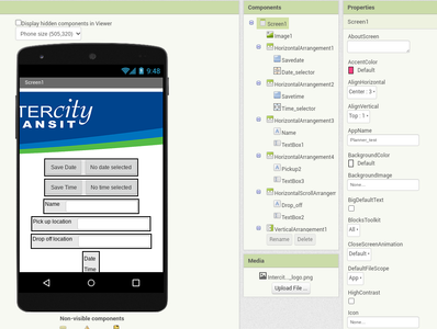

Step 5: Create Design for App 1st ¨home Screen¨
-In order for your app to actually function or make sense, you need a place for the data to go, show up, and be used
-Now you must design your first app ¨home screen¨
To create the actual buttons/operating parts
-Firstly, scroll down on the left side bar to layout, click on it, and under that click horizontal layout, click and drag onto your screen
-From there, create your save date and place for app users to enter the date requested, to do this firstly crate your save date button by clicking and dragging button on the left sidebar into the box created by your horizontal arrangement
-Under text on the furthest right sidebar properties type in the new name of your button, ¨save date¨
-Now, on the left sidebar under user interface click and drag datepicker into your horizontal arrangement alongside save date, and rename to ¨no date selected¨
-Now do the exact same thing, new horizontal arrangement included, but instead of naming you button save date it will be save time, and instead of selecting date picker select time picker and rename that no time selected!
-you guessed it a new horizontal arrangement, this one is for name input! Click and drag ¨label¨ from user interface on the left sidebar into your arrangement, and after that textbox (also under user interface) on the right side of it-then rename your label to say ¨name¨
-Do this same thing with a new horizontal arrangement each time for pick up and drop off location
-you need to add the current date and time buttons, and to do this instead of a horizontal arrangement use vertical! then insert two label boxes and name one date and one time
-Top this all off with your submit and clear buttons, inside a horizontal arrangement.. using buttons from user interface
-make sure to click and drag your non-visible components onto your screen, including tinydb1 under storage, firebasedb1 under experimental and notifier1 under user interface
To add an image onto your screen:
-first navigate to the image option on the left sidebar under user interface, click and drag it onto your phone ¨screen¨
-Select the image box now on your phone ¨screen¨ and now on the furthest right sidebar, select the text box under picture that reads none... and upload your file!

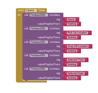

Step 6: Begin to Code for Receiving System
To create your receiving system for your app, navigate to the add screen button on the top of your screen, type in your new screen name and voila! there you are
-Now, you must code for a block that will constantly be running and updating the information in your receiving system
-click and drag ¨when clock1 timer¨ from clock1 onto your screen and create a new block
-click and drag in 5 ¨call firebasedb1 .timer¨ into the block
-attatch 2 of the ¨ ¨ blocks from text to each firebasedb1 block, the first of which will have the name of your label (ex: name, pickup location, etc..) and the second will have ¨nothing¨ -this is so that if there is no new information, nothing will be changed or updated in firebase

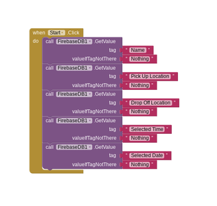

Step 7: Coding Block for Holding Info
-make sure you are in blocks mode at this point
-now, create a block that will take and hold onto the previous data from firebase
To code for this first ¨holding¨ block:
-Click and drag ¨when start click¨ onto your screen and create a new block
-from there do the exact same thing done in step 7!

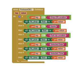

Step 8: Code for Block to Fill in System Labels
-You're nearly done coding! for this part, you need to code a block that will take the information from the ¨holding¨ block and use it! This block will essentially take data and fill in the corresponding label on your apps new screen-which you will create just after this
-under firebase on the right-hand panel click and drag in ¨when firebase gotvalue¨
-click and drag an if then else if block and fill in with corresponding blocks as shown in photo
-These get tag and their corresponding locations you will fill them in with will retrieve the information held by the previous block and assign it to the label box you give it!
