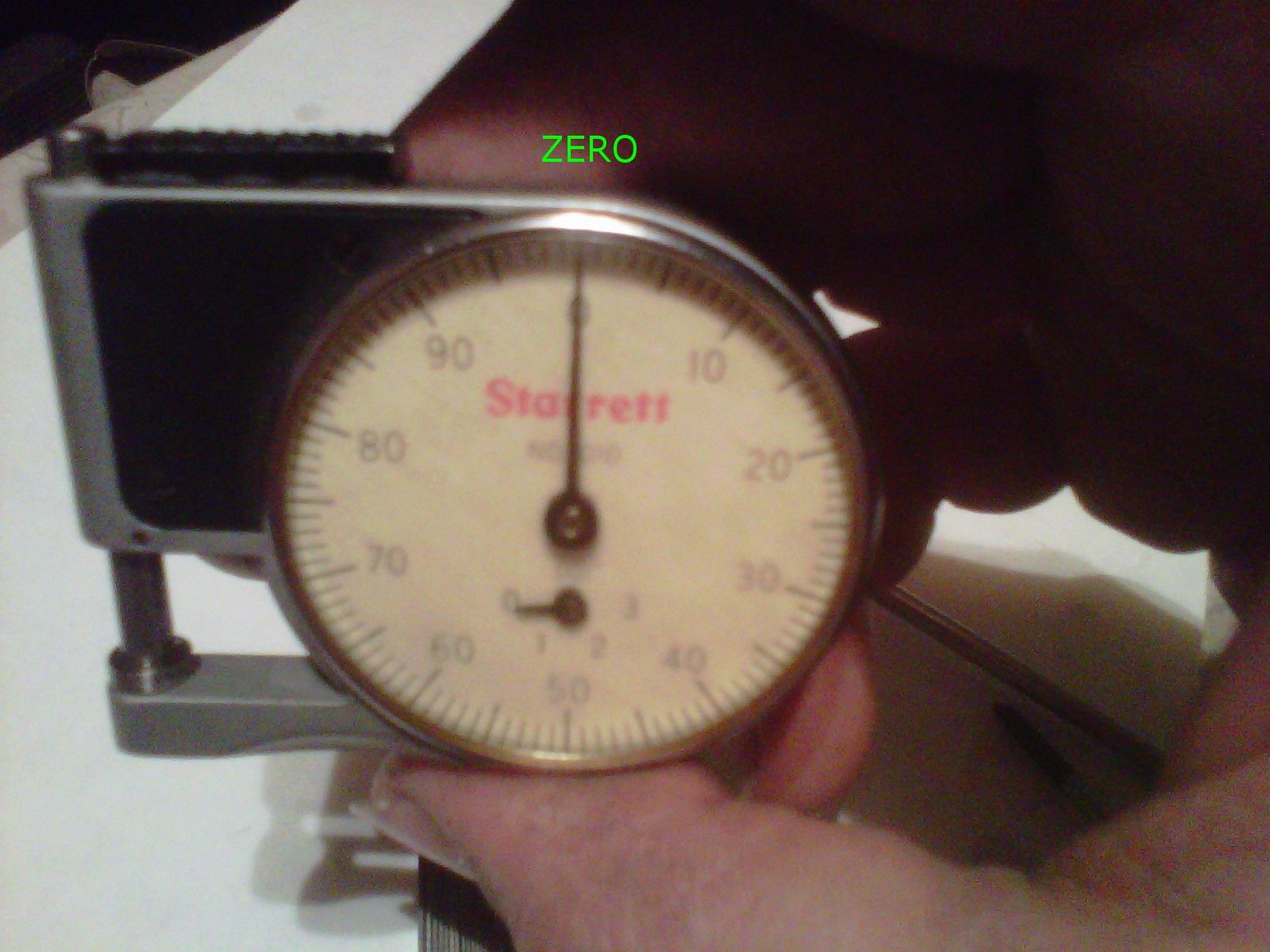

This next tool is very important! Without, it, any solder or debris can remain between the tiny pins, causing all sorts of trouble. The first time I soldered everything, I had tiny bits of solder bridging connections, so it didn't work.
I had a small utility/box cutting knife laying around, the kind where you can break off the tips to get a new sharp edge.
I very gently took enough meat from each side, so that the blade was thinner than paper, to fit between the grooves. You do not want a super thick blade that will push the pins aside, breaking their solder connections. (This happened to me, but was easily repaired)
A blade so thin it flexes is not good, either. I got mine pretty thin, though.
