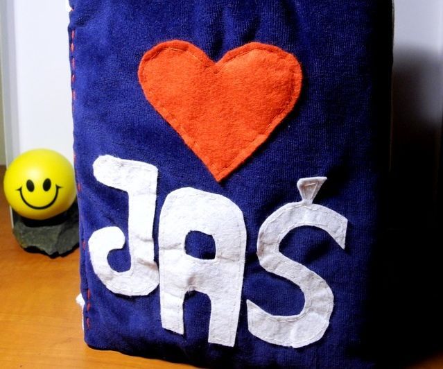

I was lucky to have an unused sponge bag that had this plastic mirror sewed in. The material was not so bad, so I used it together with the mirror. What I added was the name of my baby made of felt letters and two felt hearts. I was told that babies like to look at their own reflection. If you don’t have any sponge bag or any other item with a plastic mirror on hand, you can always buy one or ask your friends if they have a spare one.
