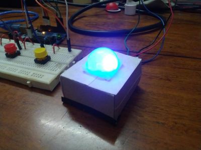

Step 1: Build Procedure

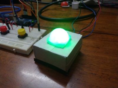

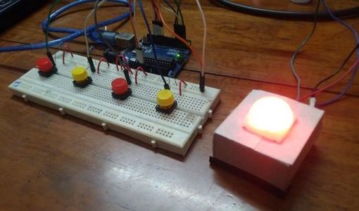

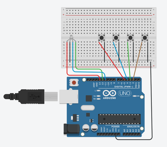

We have used an Arduino Uno board and connected an RGB LED light to it. There are 4 push buttons connected to the Arduino Uno board.
3 of the push buttons are responsible for controlling the ON state of the Red, Green and Blue of the RGB LED.
The fourth Push button is responsible for switching OFF the LED light.
Arduino UNO < -- > RGB LED Light
Pin 13 < -- > Red Cathode
Pin 12 < -- > Green Cathode
Pin 11 < -- > Blue Cathode
Pin GND < -- > Anode
Pin 2 < -- > Push Button 1
Pin 3 < -- > Push Button 2
Pin 4 < -- > Push Button 3
Pin 5 < -- > Push Button 4

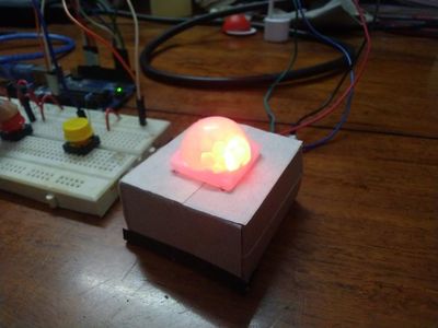

Step 2: Result

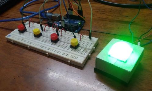

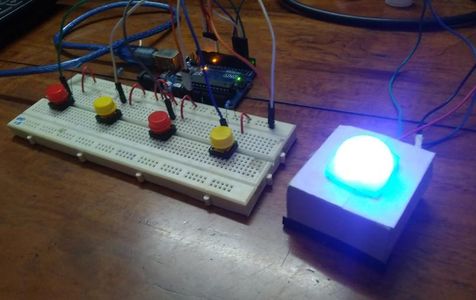

Out BUSY LIGHT works. We can use it for setting our status during work.
There are 3 color Modes - RED - Do Not Disturb BLUE - In A Meeting GREEN - Available
