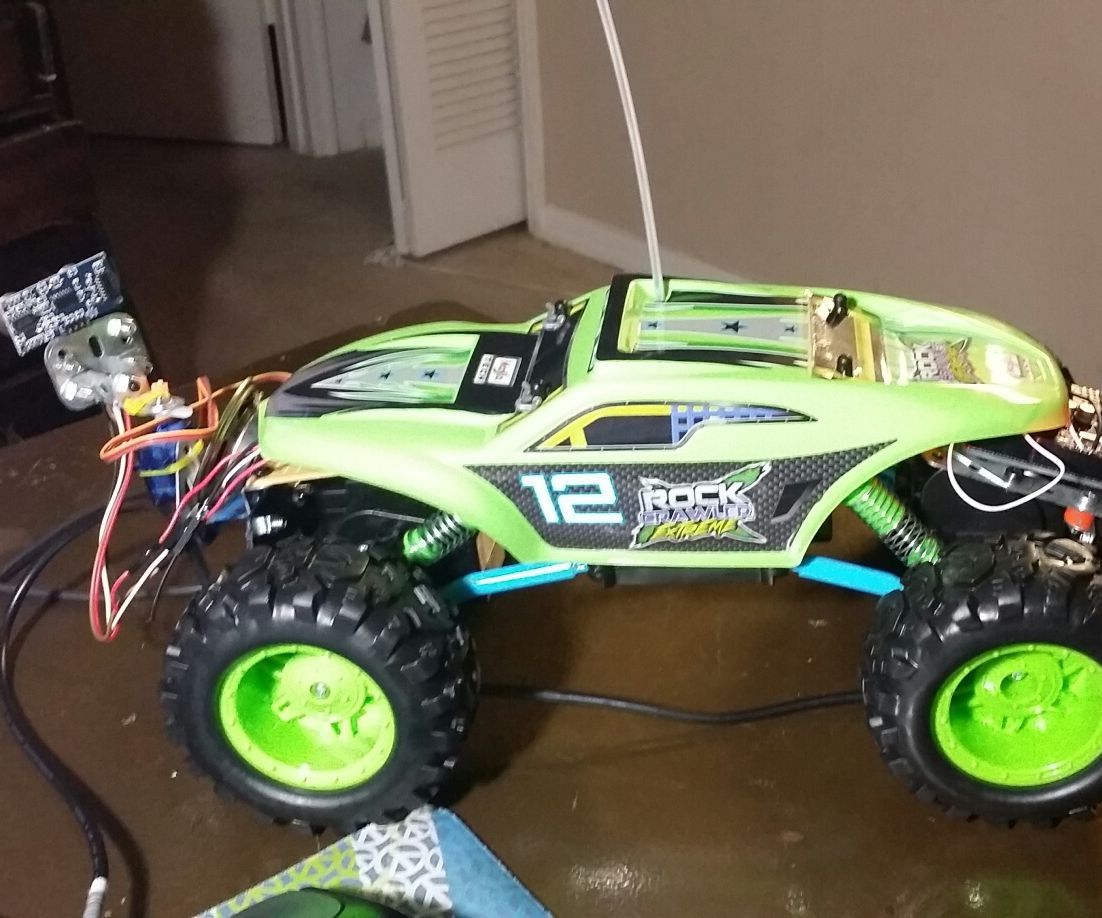

Introduction: Butch - Remote Soil Monitor Watchdog
Butch was designed to monitor the moisture in soil from a distance. I created this so I can check the moisture level on nearby plants without going outside.
This model version does not continually monitor the soil, but only reads when I remotely send a signal to the IR receiver to monitor the soil.
