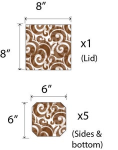

  • Cut out five pieces of 5"x5" board for the sides and bottom of the outer box
  • Cut another piece slightly larger (5 1/4"x5 1/4") for the lid, and four strips of it for the sides (each 5 1/4" x 3/4"--ignore the one-inch size mark on the diagram, 1" is really too wide)
  • Cut out two pieces of 4"x5" chipboard and two more of 3"x5" for the inner box
Then cut the paper with which you want to cover them.
  • For each of the 5"x5" boards, cut a 6" square of decorative paper, and cut the corners off of each of these squares 1/2" in from each corner.
  • For the lid, you will need a single sheet of paper that is 8"x8". Do not cut off the corners of this piece.

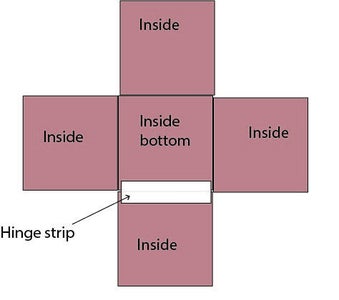

The paper hinges can be attached next. Each is just a strip of paper which I have adhered in place using iron-on fabric webbing. For the outside four sides of the box, It is important that each strip extend along the entire length of the side it is hinging. If this is not done, the bottom of the box will bulge outward when it is armed with the butterflies. Each strip, therefore, needs to be five inches long (you need four of these for the outside box, which means four 5" long hinges) and each should be at least an inch (better off two inches) wide.
Spray adhesive will not tend to hold these in place with sufficient strength, which is why I used and strongly suggest webbing. Each of the side pieces should lay right up against and touching an edge of the bottom piece.before ironing the paper hinges and webbing in place-- you should not leave any kind of gap between these pieces, since these hinges will be folding upward and inward.
If you are very clever you can cut a single cross-shaped piece of paper that is 7" on a side and has 1" squares cut out of each corner, and if you center this on the inside of your bottom piece, you can use it to create all four hinges for the outer box at once. You cannot do this for the inner box because its parts do not lay flat, but you can do it with the outer box. You will need to make sure your measurements are rather exact to do this successfully, but it will be quicker than creating four separate hinges and ironing each in place. If you create the hinges this way, you will still want to use iron-on webbing to secure it in place, right up to the edges of each of the outer box pieces as well as all over the inside of the bottom piece. If this sheet of paper is loose in the middle, the inner box pieces will not stand up correctly, and if loose at the edges it will not hold the outer box pieces in place securely.
Once the hinges have been placed, you should be able to lift your box from one side and have the whole thing lift up as though it were a single flat cross-shaped piece of decorated chipboard. If the side pieces sag downward when you do this, this means you have not attached them snugly enough against the bottom piece-- you left gaps where you needed to leave no gaps! Fortunately, since you used iron-on webbing to attach the hinges, you can use the same iron to liquefy the webbing, lift up and replace the paper hinge, and relocate the pieces closer together so that they touch all along the edge.
If you have used fabric to create your hinges, and have used liquid fabric adhesive to attach them, then you will not be able to relocate these hinges once the glue has dried. In this case, you must do your best to fix the problem by placing additional adhesive into the hinges, pinching them solidly with a butterfly clip or clamp, letting them dry, and testing the box again. Webbing is forgiving; adhesive is not.
A word about using webbing: the goal is to create hinges that are tight-- so that when the sides are folded up, there is only the very smallest gap between them. They will come together well enough at the top, but the real trick is to get them to have no gaps at the bottom! To do this, if you are using webbing, it will be important that the webbing is laid right over the line where the side pieces attach to the bottom piece. If your webbing is not placed directly over this line, then you will end up with a gap between the bottom and the side piece when it is folded up, which will look clumsy.
The goal is to create a box which does not look like it is about to come springing apart once opened. If there are gaps around the sides, this will give things away. Also, if your paper or fabric has a directional pattern, it will be important that this pattern run the same direction (either horizontally or vertically, your choice) around all four sides of the box (for the bottom and the lid, this will not matter, but for the sides, if the paper/ fabric has a directional pattern, it will be very important).

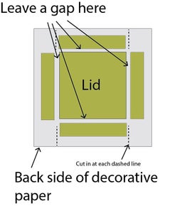

Step 3: Creating the Lid
The lid is more complicated. It can be done a variety of ways. Here is one way:
The picture is worth a thousand words. Use spray adhesive, place all of the pieces as shown, adhere together, then cut the tabs, and fold up the edges, making sure you have left the indicated gap. I wrote longer more detailed instructions, but the Instructables app accidentally deleted them and I do not feel like recreating them. You should easily get the idea from the photos, however.

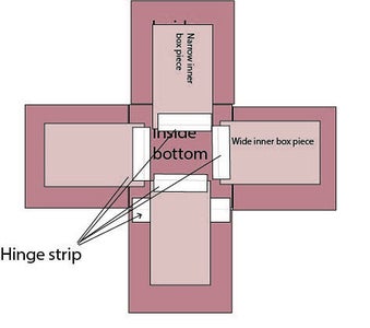

The next step is to create the inner box using the four inner box pieces. These are created using hinge joints like the ones used to attach the box side pieces to the bottom piece, except that here we will be attaching two surfaces that are not at the same level (which makes it slightly trickier) and we will be attaching the two smaller pieces slightly inside the two larger ones.
There are two "bigger" inner box pieces and two "smaller" ones. Adhere the "bigger" ones 1/2" in from the edges of the box by laying them flat in place and then covering the inside edge with a paper hinges joint. Make sure that there are at least 3" between them on the inside. Now place the remaining 3" pieces between these, and create hinge joints for them the same way. In the end, your 3" wide pieces should fold up and inside of your 4" wide pieces.
However you cut or place these pieces, you must be certain to not place them so close to the outer box sides that you cannot fit the butterflies between them, nor so far from those sides that the butterflies will come untwisted once they have been inserted. It needs to be a gap of very close to 1/2" wide to meet these requirements.

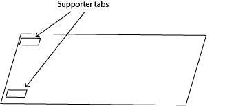

Step 5: Supporters
The next step is to create supporters/ tabs for both the inside and outside boxes so that they cannot collapse in on themselves, I created my supporters from small rectangles of chip board (about 1/4"x1/2") stacked three high and attached with hot glue to each other and to the box sides. Place two such supporters on the inside top edges of the two opposing sides of the 4" wide inner box pieces and two more on any two opposing outer box sides. They should be placed about 1/8" in from the edges of each piece to which they are attached. Make sure the glue holding them is SOLID. If it is not, the side may collapse inward. Hot glue is fast, but unless you apply it while very hot it may not make a strong enough bond. Elmer's is better, but takes several hours to dry.
