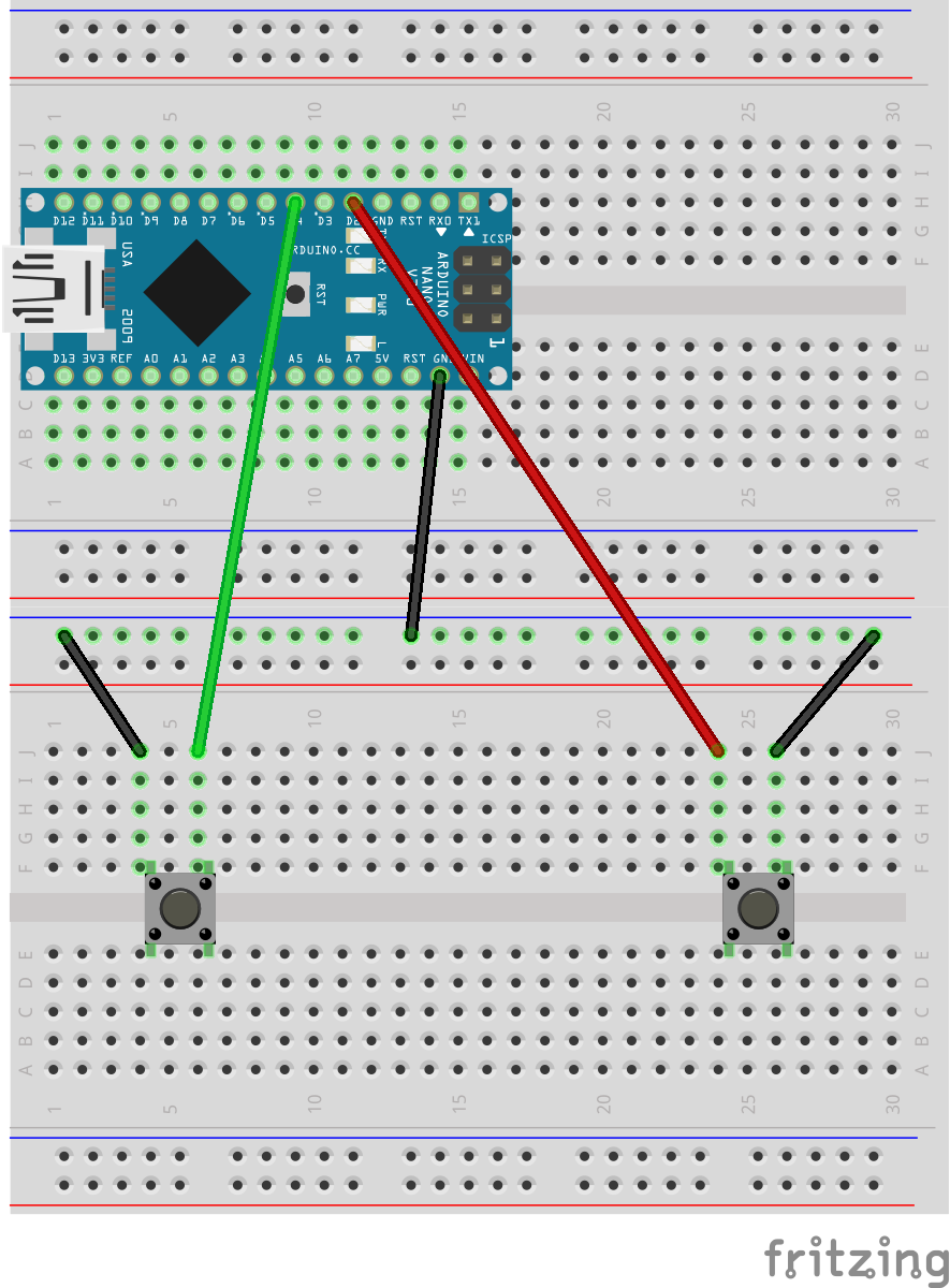

Step 2: Connections
  • Connect D4 to one pin of the button on the left side; connect GND to the other pin of the button.
  • Connect D2 to one pin of the button on the right side; connect GND to the other pin of the button.
