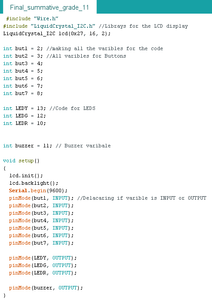

Step 3: Code
Now finally the code. It is fairly simple. First I define all the variables to be used in the project. This being all the buttons, LEDS, and the buzzer. The reason we don't have any variables for the LCD is because the code is already pre loaded onto A5 and A4.
Next would be to define each variable is a OUTPUT or INPUT (void setup();). Every button would be a OUTPUT. Now every other other component, being the LEDS, and buzzer, would be a INPUT. You also need to do Serialbegin(9600); to start the serial monitor. Lastly you need to do some commands for the LCD screen.

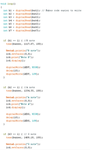

Lastly is the void loop(); function. This last step is fairly simple. All I do here is first make each button variable equal to a smaller letter, so it is easier to right later on. Now next I test each button to see if it is being pressed. If it is it gives commands to play the right frequency to the buzzer, write the text onto the LCD screen to tell you what note it is, turn on a LED, and finally print what note it is to the serial monitor. After doing this for each button, the code is complete. Below I have the download to the code so you can examine it more closely and use it for your self in this project.
