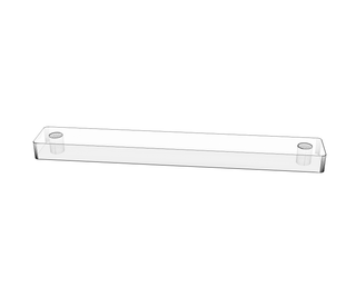

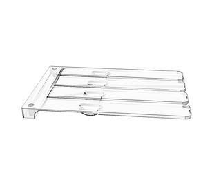

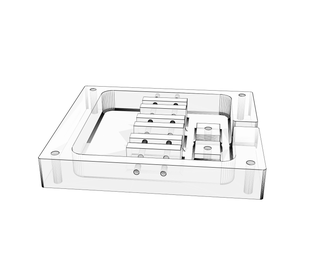

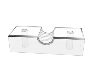

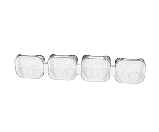

Step 1: 3d Print Buttons and Case.
First step is 3-D printing the buttons and cases for the button box.
There are 5 STL files you will need. Print one of each.

Assembling the button box is pretty straightforward. I have included a exploded view so you can see exactly how it goes together.
