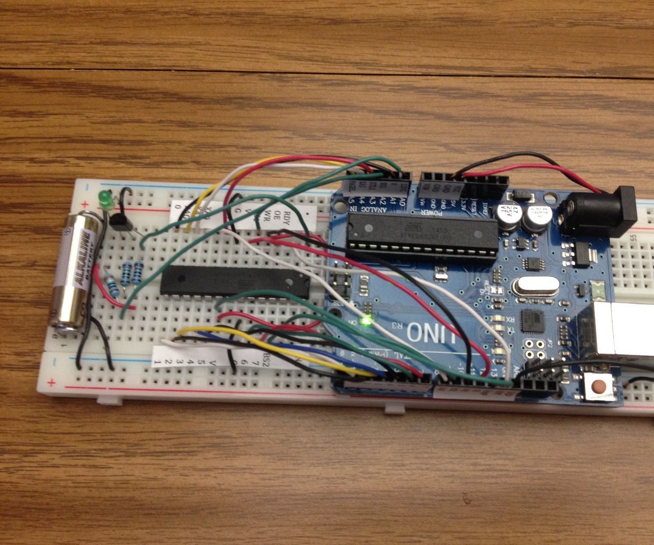

- You can program an Arduino to be an ISP programmer, and then program another Arduino with it, to re-burn the bootloader or to load a sketch without using a bootloader.

You can use your other Arduino as an ISP programmer to burn the bootloader or other programs onto the blank new chips you insert.
