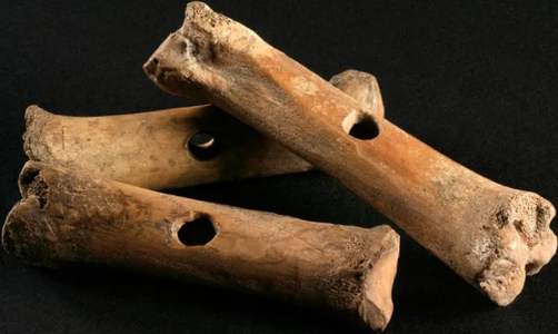

The noise-making toys known as ‘buzz-bones’ are crafted from a small animal bone (often a foot bone such as a pig’s metatarsal) with one or two holes bored through the centre. They survive from the prehistoric period all the way up to early twentieth-century Shetland and Orkney, where they are known as ‘snorie banes’ or snoring bones, but they seem to have been especially popular in medieval Europe.
Examples from the Middle Ages have been found in settlements including Norwich, Bristol, York, Dublin, and Birka in Sweden, dating from early as the eleventh century right through to the sixteenth. In the past, when these bones were found by archaeologists they were often misidentified as toggles for clothing, but more recently they have begun to be recognised as devices that made a sound and were designed to entertain.
Some reconstructions of buzz-bones have previously been attempted, including by Norwich Castle Museum and Art Gallery, but the difficulty of preparing the animal bone makes for a time-consuming process; the bone needs to be cleaned through gradual soaking, which even after weeks can leave grease and residue and leave the bone at risk of rotting. No videos of buzz-bones can be found online, suggesting that the difficulty of treating the bone or finding a functional substitute has held back researchers and reenactors from making them. The experience of enjoying and fully understanding this toy has therefore mostly been out of reach for a long time.
