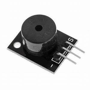

Step 2: Schematic - Esp32 With Buzzer Sensor
In this section, we will see how to connect buzzer sensor with ESP32. The buzzer sensor will be connected with the ESP32 board with its 3 pins.
Follow the schematic diagram for the ESP modules and connect them accordingly. Connect the ESP32 device with the buzzer sensor as shown in the schematic diagram above:
Pinout of the buzzer Sensor :
buzzer Sensor - ESP32
VCC - Power Supply
Data - GPIO
GND - GND
Wire the buzzer sensor to the ESP32 as shown in the following schematic diagram. We’re connecting the vcc pin to 3v/5v and the buzzer pin to GPIO 23, but you can use any other suitable pins, and GND pin to GND of esp32.
ESP32 Wiring With buzzer Sensor :
Buzzer Sensor - ESP32
VCC - 5V / 3V
Data - 23 (ANY GPIO)
GND - GND
