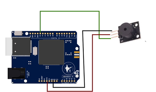

Step 2: Connection
To connect a buzzer to a Bharat Pi board, you'll typically use one of the GPIO pins to control the buzzer. Here's a basic outline of how you can wire up a buzzer to Bharat Pi and control it using Arduino code:
Wiring:
  1. Connect one terminal of the buzzer to a GPIO pin on the Bharat pi (for example, GPIO pin 23).
  2. Connect the other terminal of the buzzer to a ground (GND) pin on the Bharat pi.
  3. Optionally, you might need a resistor in series with the buzzer to limit the current if the buzzer's voltage rating is lower than the output voltage of the GPIO pin.
