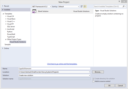

First let’s start by creating a blank solution. I know there is a Xamarin.Forms template but it still uses the old Windows Phone 8.0 Silverlight project that we don’t want. I also just find it slightly full of clutter and frustration on VS 2015 (my new best friend…). You’ll then face something like this the first screenshot.

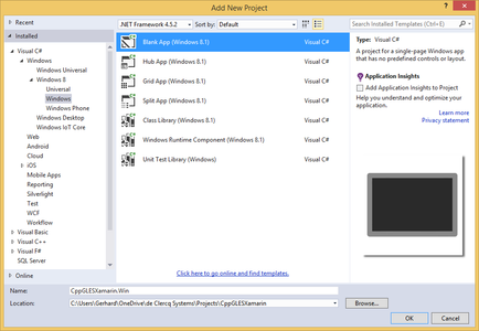

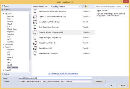

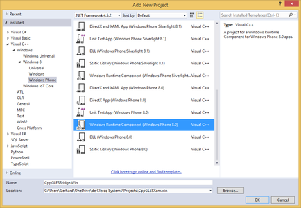

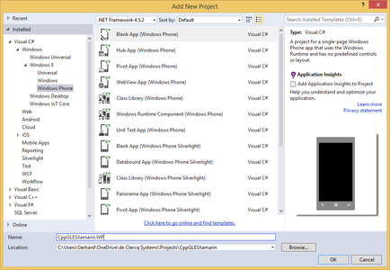

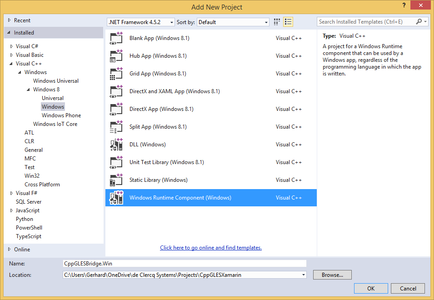

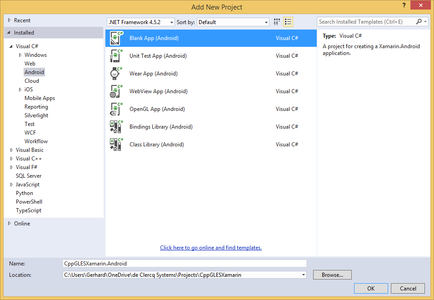

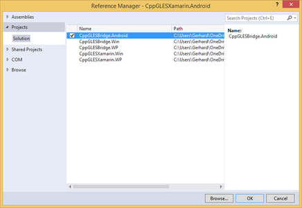

Next we need to create the individual projects one by one. We’ll start with the Windows projects first and then do the others later once we have the Windows ones working. So we’ll firstly need a blank WP 8.1 and Win 8.1 C# project. Then we will need a C++ WP and Win Runtime Component. Finally we will need a shared C++ project for the Runtime Components. I have added some screenshots of each project being created with an example name below.

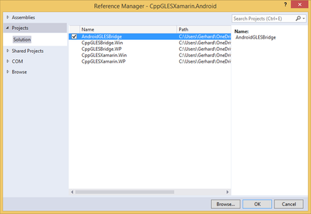

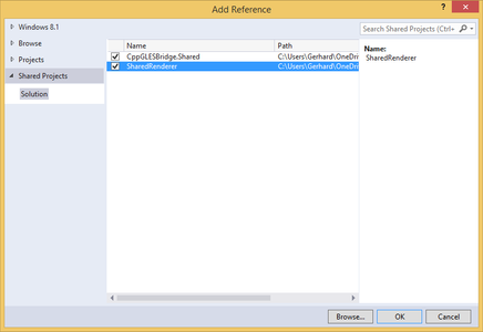

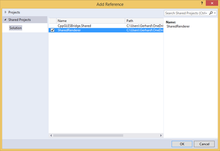

Remember to add the shared references by right clicking on the actual projects’ “References” property, selecting “Add Reference…” and selecting the appropriate shared project.
These projects will contain all the platform specific code that we need to get a GLES viewer component and Renderer object exposed to the shared (I guess Xamarin compatible) C# code for the application that we will be creating a little later.

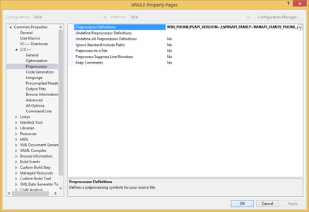

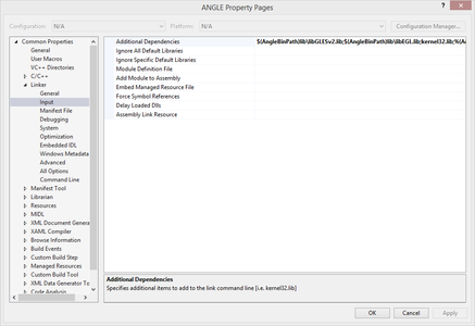

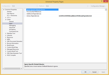

Step 2: Get ANGLE
Before you can go on you will have to install Microsoft’s branch of the ANGLE project (https://github.com/MSOpenTech/angle) which will allow you to access OpenGL ES on all the Windows platforms through a process of intelligently wrapping DirectX. The way I recommend one does this is by adding it as a Git project in Visual Studio. This will allow you to easily sync in any new updates and easily push any modifications you make to your own branch where you can then make a pull request. You could also just download the zip archive and go from there. I believe they document the installation process very themselves but in essence the installation involves that you have to open the project for each platform and then compile it for each configuration and architecture (Debug, Release, x86, x64(on Win Store), ARM). For this tutorial you will only need the Windows 8.1 and Windows Phone 8.1 binaries, not the Desktop or Windows 10 ones. After you have compiled them all you will need to run the install script in the source directory. This will setup your environment variables so that VS knows where to find the ANGLE binaries and headers.

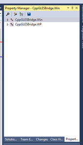

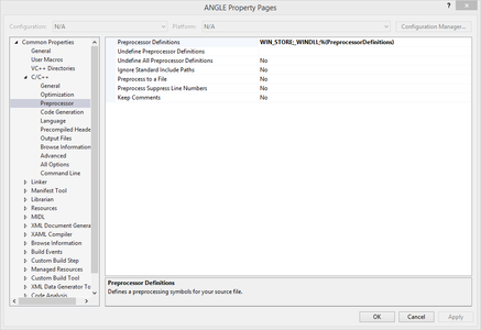

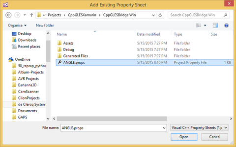

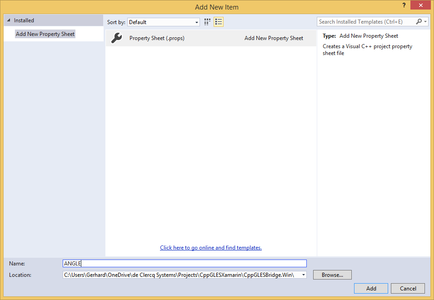

Now we will need to create some Macros that will define where ANGLE is installed. Start by going to the “Property Manager”, you can get there using the search box in the top right corner. So now right-click on the Windows project and select “Add New Property Sheet…” Call it “ANGLE”. Now open it by double-clicking it in any configuration. Finally go to user Macros and add “AngleBinPath” and “AngleIncPath”. The “Bin” one should point to “$(AngleRootPath)\winrt\8.1\windows\src\$(Configuration)_$(Platform)\” and the “Inc” one to “$(AngleRootPath)\include\”. Make sure to enable the Macro for the build environment. Just do the same for the Windows Phone project but this time use “$(AngleRootPath)\winrt\8.1\windowsphone\src\$(Configuration)_$(Platform)\” instead of “$(AngleRootPath)\winrt\8.1\windows\src\$(Configuration)_$(Platform)\”. The include path remains the same.

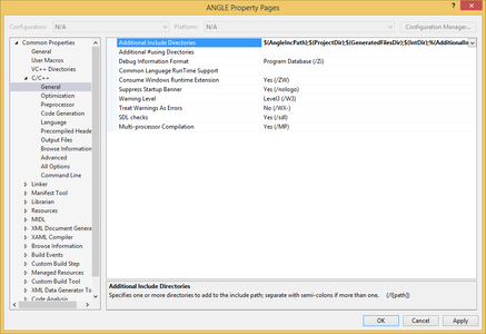

Now that we have the macros we need to add the include directories to the project as well as the libraries that the linker should link to. So please do the following on the property sheet of both the Win and WP projects. On the left you will see a “Linker” group and on it an “Input” page. Open it and prepend “$(AngleBinPath)lib\libGLESv2.lib;$(AngleBinPath)lib\libEGL.lib;” to the “Additional Dependencies” field. Also go to “C/C++” and then “General”. Here you need to prepend “$(AngleIncPath);” to the “Additional Include Directories” field. As this is one Property page, you only need to do this on one configuration and it will applied throughout. Just remember to do exactly the same thing with the Windows Phone property page.
Next we need to add the DLL files to the C# projects. This is unfortunately working way that I could find to get them copied to the runtime directory and without them there you get a host of errors. So for both the Win and the WP C# projects add libEGL.dll and libGLESv2.dll as existing files. Leave them configured as “Build Action” “Content” and “Copy to Output Directory” “Do not copy”. It does not matter which DLLs you choose now because we will be changing their paths later on to automatically point to the correct files (we need a different one for each configuration). So once you have them, open the directory where your project is. We now want to find the Windows .csproj file and open it with Notepad. Remember to just save everything before doing this. You now have to find the location where the inclusion of the DLLs is declared.

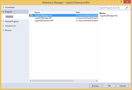

Next you can just add references to the runtime components in your C# projects. Make sure to use the WP one for the WP project and the Win one for the Win project.
Before going any further I would recommend you check and see if you can still compile and deploy the application. Just remember to choose an architecture like x86 or ARM as “Any CPU” will give errors with the native libraries. If everything is working fine you should see an empty application start up.

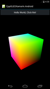

Step 3: Create the Renderer

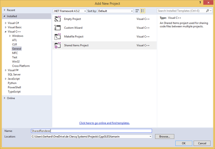

Next we are going to start with the code needed to get something rendering. For this I just modified the GLES code provided in the ANGLE template that draws a spinning cube. So now add a SimpleRenderer class to a new shared C++ project that we will call SharedRenderer. This will later also be shared by the other projects. Also just reference this project in the Runtime Components.
Please just start by turning off precompiled headers because this does not currently play nice with Android shared C++ in VS 2015 RC. This is because a VS shared C++ project can currently not see any files in an Android C++ library project. Here's hoping Microsoft fixes it soon. You can do this by going to your ANGLE property page on both Win and WP and simply selecting “Not Using Precompiled Headers” in the “Precompiled Header” field in the “C/C++” group.
I am not going to discuss what the following GLES code does as it is beyond the scope of the tutorial. So just put the following in the header:

Step 4: Create the Windows Platform(s) Support Layer
We now need to add Microsoft’s OpenGLES helper class to the Shared C++ bridge project. So please just add a class named OpenGLES to that project.
The header should contain:

Ok so now for the CX (Microsoft’s runtime C++ extensions version of C++ or whatever it’s called)/(The version of C++ with the very funny syntax) wrapper that will provide us with a seamless C# interface. For now we will be using a modified version of the MainPage code found on the ANGLE template. As this page is now actually a C# object, we will have to route the events from C# to C++. The rest of the code can be kept as is in the C++ as to keep things simple.
So now create a class in the shared bridge class and call it GLESSurface. The class will need to be in a namespace with the same name as your project because otherwise you will get errors when trying to compile the C# application. The problem is that this namespace is different for the Windows Store and Windows Phone projects. To fix this we need to add some preprocessor directives. For the store project I added “WIN_STORE” and for the WP one “WIN_PHONE”. Maybe there are already some default ones that would work but I could not find them and just went with these. With these I could then use the following in the header file to define the needed namespace:

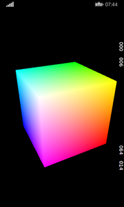

There are screenshots for both the finished Windows Phone and Windows Store files.
If you build and run your projects now you should see a spinning cube.
Step 5: Add Android Platform Support Layer
Ok so now we can move on to Android. Start by creating a blank Android C# project. We will also be needing an Android C++ Dynamic Library Project. I would recommend refraining from putting any special characters like a ‘.’ in the name of this project because it might confuse the VS Android toolchain. We then need to reference the Android C++ library in the Android C# application and also add a reference to the Shared C++ renderer project in the Android C++ library project. I would also recommend that you change the API of the C# project to 19 in order to match the C++ one which defaults to 19. You could also just change the C++ project's API level to the newer one but using an older one will give you access to more users if you don’t need any new APIs.
In order to get the shared code working we will need to tell the linker to link to the math and GLESv2 Libraries. In order to do this, add a property page to the Android C++ Library project and call it something like “Universal”. You then need to go to the Input page in the Linker group and prepend “m;GLESv2;” to the “Library Dependencies” field.
You should now be able to get your Android C# application compiled and running, though it won’t show anything fancy just yet. Next we will need to create some C# classes in the Android project. Firstly create a class named MyGLRenderer.

Go to your C++ Android Library project. Delete the default header because we don’t need it. Replace whatever is in the default .cpp file with the following:
This is just a little piece of C code that allows us to call the necessary methods of a static SimpleRenderer object. Unfortunately it is not possible to access C++ objects directly through P/Invoke (DllImport). You will need a piece of “object agnostic” C code like this to wrap the interface. I recommend that you create these types of wrappers in the Android specific code and not the shared code. Just like you should not put the CX code for Windows in the main shared C++ project. This is just to remove the unnecessary clutter and possible confusion.

If you compile and run you should now see a nice spinning Cube.
