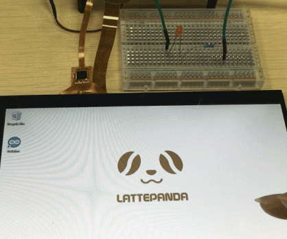

Step 3: 2. Communicate From the LattePanda CPU to the Arduino
Function:
- Computer: Send '1' or '0'
- Arduino: Receive '1' and turn on the light. Receive '0' and turn off the light.
Creat a new Windows Form Application and make two buttons. See the picture above.
C# Code:(Winforms)
using System;
using System.Windows.Forms;
using System.IO.Ports; namespace lightcontrol { public partial class Form1 : Form { SerialPort port; public Form1() { InitializeComponent(); this.FormClosed += new FormClosedEventHandler(Form1_FormClosed); if (port==null) { port = new SerialPort("COM7", 9600);//Set your board COM port.Open(); } } void Form1_FormClosed(object sender,FormClosedEventArgs e) { if(port !=null &&port.IsOpen) { port.Close(); } } private void button1_Click(object sender, EventArgs e) { PortWrite("1"); }private void button2_Click(object sender, EventArgs e) { PortWrite("0"); } private void PortWrite(string message) { port.Write(message); } } }
Arduino sketch:
const int LedPin = 13;
int ledState = 0;
void setup() { pinMode(LedPin, OUTPUT); Serial.begin(9600); } void loop() { char receiveVal; if(Serial.available() > 0) { receiveVal = Serial.read(); if(receiveVal == '1') ledState = 1; else ledState = 0; } digitalWrite(LedPin, ledState); delay(50); }
If you click the button 'ON', you will see the light(pin13) turns on.
