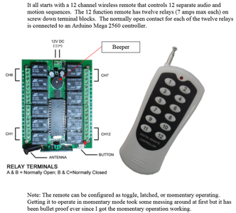

Step 2: Control - Wireless Remote

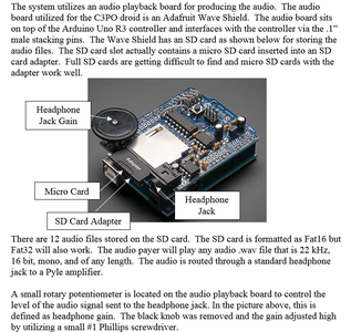

Step 5: Control - Arduino WAV Shield

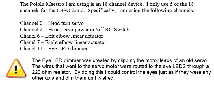

Step 7: Control - Pololu Maestro Servo Controller

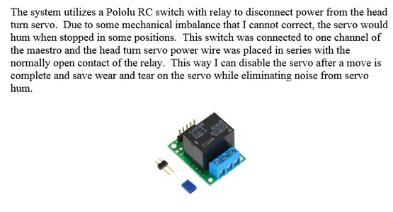

Step 8: Control - Pololu RC Switch With Relay

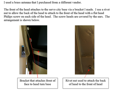

Step 15: Head Rotation Servo

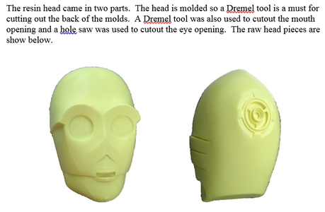

Step 20: Resin Head
Step 21: Eyes

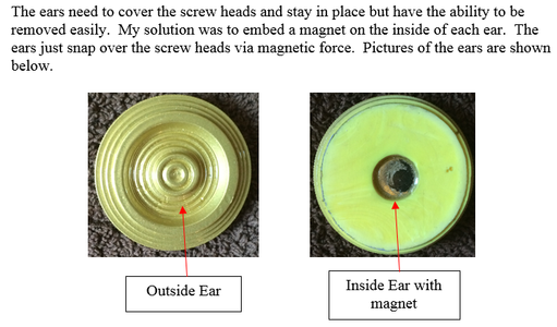

Step 22: Ears
Step 23: Ears

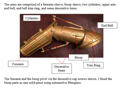

Step 26: Arms

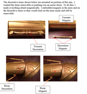

Step 27: Decorative Item Attachment

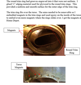

Step 29: Round Trim Ring

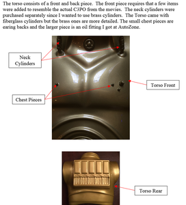

Step 33: Torso
Step 34: Ribbing

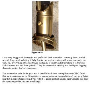

Step 35: Paint
Step 36: Paint

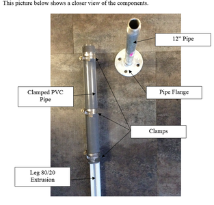

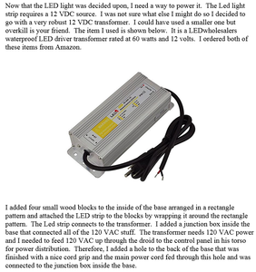

Step 37: Base
Step 38: Base Construction Detail
Step 39: Base Construction Detail
Step 40: Base Lighting

Step 43: Pololu Maestro
The Pololu Maestro controls the head, left elbow, and right elbow servos. The Pololu Maestro also controls the eye leds. To allow the eyes to fade up and down, a servo is attached to the Maestro with the motor removed and the leds are connected to where the motor leads of the servo went. The feedback pot was left in the servo circuit so when you give a servo command, the leds will brighten due to feedback error and more voltage being sent to the motor since the servo will try to get the feedback to match the command. The head servo would hum from time to time when the servo was stopped, this is due to some mechanical imbalance that I could not correct with the current setup. Therefore, I added a Pololu servo controlled relay that removes power from the servo when the head move is complete. The relay is just connected in series via a normally contact to the head servo power. This setup saves the servo from excessive wear and eliminates all noise when there is no motion. This has worked out great since I can move the head without the servo fighting me when I want to wipe things down for cleaning. Refer to the electrical drawings for hookup information.
