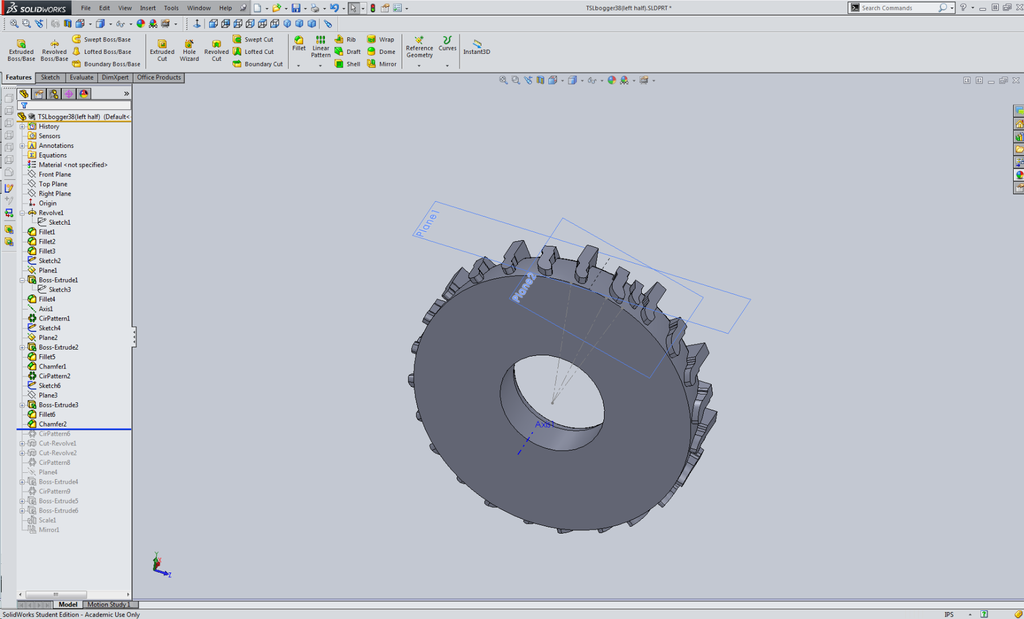

Step 3: Create the First Section of Tread
Since this tire has three separate pieces to the tread, we will draw in in three separate steps. First, create a center line from the center of the tire out to the edge, in the plane of the inside face of the tire (where the two halves should join. Next, create a reference geometry plane that is coincident with the endpoint of the centerline, and perpendicular to the center line. This gives you a plane that is tangent to the surface of the tire.
Draw the first part of the tread in the plane. This is most easily accomplished by looking at the tire tread you are trying to copy, and deciding how big each piece should be in relation to how big the tire is. You should get something that looks like this.
After the tread is drawn, we extrude it. The tire specs page gives a tread height of 29/32, or almost 1". I use extrude, direction 1 = blind, distance = 29/32", direction 2 = blind, distance = 5" For direction 2, you can use whatever distance you need to make sure the tread is part of the tire. Make sure you select "merge" or the tread piece won't be part of the tire!
Once the tread section is created, add a central axis to the tire (under insert, reference geometry, axis) and then create a circular pattern of the tread, using the new extrusion as the pattern and the central axis as the parameter to rotate about. If you look carefully at the original tire you can see it has 12 of the big tread sections, so create 12 instances in the pattern.
Step 4: Continue With the Next Section of Tread
Now, we'll add the tread section that goes in between the one we've just drawn. It's a slightly smaller section than the first. We'll create it 1/24 of a full revolution away from the first instance, so repeat the previous steps to create a plane, except separate the first center line from new center line by 360/24 or 15 degrees.
Create the extrusion just like we did before.
Using the same axis that we inserted last time, create another circular pattern, 12 instances. Repeat the previous steps to insert the final bit of tread. Since this is the smallest tread, it fits in between the other two, ans there are twice as many instances of it. So this time create your plane just 7.5 degrees offset from either of the previous planes, and create the last piece of tread.
Finally, create a circular pattern around the axis, with 24 instances. the tread is basically done!
