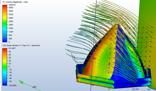

  • Step 17: Wind Testing

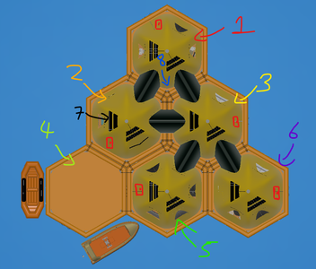

  • Step 19: Single Family Temporary Shelter
  • Step 20: The Inside
  • Step 21: Disaster-Relief Base of Operations
  • Step 22: The Washroom/Storage
  • Step 23: The Medical Room
  • Step 24: The Common Room
  • Step 25: The Dock
  • Step 26: The Work Room
  • Step 27: The Break Room

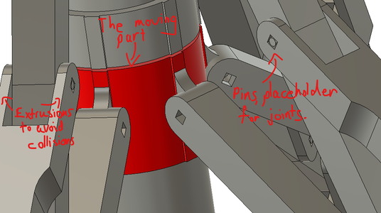

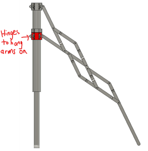

The mechanism behind the SIMPLAE is essentially a larger umbrella. It uses a central sliding ring that is attached to 6 "arms". When the red ring (the "moving part") is positioned upwards, the arms will expand, and when the red ring is downwards, the arms will retract. The bottom half of the central pole is also retractable.
Here is a quick rundown on how to CAD this part:
  1. Create a pole
  2. Create 6 hinges, and attach them to the top of the pole
  3. Create a ring with 6 hinges, and colour it red.
  4. Connect the ring to the pole with a sliding joint
  5. Create 4 different lengths of bars, which will serve as the arm parts
  6. Connect these bars together using revolve joints
  7. Modify the shape of the bars such that they do not intersect
Sadly, I was not able to figure out a way to let you actually move the mechanism in the demonstration below. However, feel free to download the model on your own to play with it if you like. You can also refer to the video at the top of this Instructable, to see how the mechanism moves.

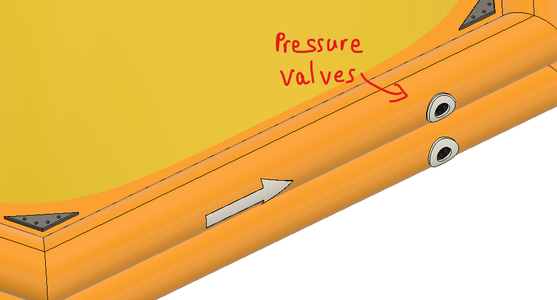

Moving on to the CAD of the exterior, .there are two main parts: the yellow "tent", and the orange "floor". However, there are also many smaller details, such as the handles to help people climb up, the arrows point towards the entrance, and the anchor points, where things can be tied to the SIMPLAE.
  1. For the tent, use the method shown in this video, by Youtuber "It's made EZy"
  2. For the floors, simply create a hexagonal prism. Then, fillet the top and bottom, and then create a duplicate on top of it
  3. For the pressure valves and the zipper, make use of different extrude types, especially "Extrude from Object"
  4. For the handle, make use of the sweep tool

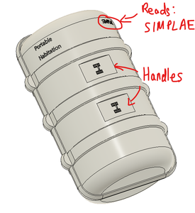

When the SIMPLAE is in its closed form, it needs a container for transportation and for protection. This container is inspired by the design for modern liferafts, and it is simple, but effective.
  • Create a hollow cylinder
  • Fillet the top and bottom
  • Sketch and revolve to create the bumps on the sides.
  • Use the emboss tool to create the text
  • Follow this guide (from Autodesk themselves!) to create the handles
Closed Simplae 1.0

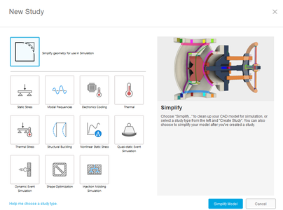

If you already feel comfortable in the Simulation workspace, feel free to skip this step, but if this is your first time creating a simulation, then this step is for you!
Although the Simulation workspace might seem intimidating from a first glance, it's not actually that hard. Here is a great video on how to use this workspace by Youtuber "Lars Christensen", and it's also the video that taught me how to do this! However, you can also follow along with the below information if you would like.
First of all, if your model is complicated, you might want to simplify it. Use the "Simplify Model" selection from the 1st image to adjust your model, deleting unnecessary faces and objects, until you are satisfied. Then, create the study that you want from the top left corner. I won't go over them all in this Instructable, but they come with great description texts, which I highly advise that you read through.
After creating your study, the Simulation workspace is super intuitive, in that you just need to go from left to right, across the toolbar, as shown in the 2nd image! Following the step numbers, first, enter the "Materials" tool to assign the necessary materials to your objects. The simulation will work best with rigid materials, such as metal or wood, but you can still get by with materials such as flexible PVC (which is what the SIMPLAE floor uses).
Next, use the "Constraints" tool to set up the constraints on your object: which are things that will limit the bodies motion, such as screws, walls, and floors. Then setup the force that will be exerted on your component, using the "Loads" tool. Next, press "Toggle Mesh Visibility" to generate the mesh, and then you are done the preparation! Now, simply use the "Pre-check" tool to make sure you aren't missing anything, and then hit "Solve". Finally, check your Simulation Results, and you are done!

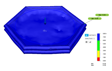

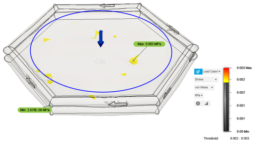

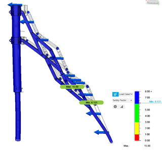

First, we will create a simulation of the floor, to see how well it can handle the forces of the people moving on it, as well as all the furniture and such which will come with them.
The load I used was 10000 lbs of force. This is because U.S. building codes dictate that residential buildings must bear a minimum uniform live load of 40 lbs per square foot. Since the SIMPLAE is not designed to carry particularly heavy loads, this metric seemed fitting. Using the figure of 40 lbs per square foot, the floor would need to carry 9143.80 lbs of force, which I rounded up to 10000 lbs. Note that the material I used for the floor here was Expanded Polystyrene, since life raft floors are often made out of similar materials, due to the high compressibility and temperature insulation.
TIP:
In the above images, you might notice that the floor looks heavily deformed by the load on top of it, even though the simulation says the deformation is small! Don't worry, since this is because Fusion 360 automatically adjusts the visible deformation, to make it more apparent. To change this, simply click "Actual" from the "Deformation" panel. If you do so, you'll find that our floor is completely fine, and hardly deformed at all!
As shown in the 1st image, the floor is very well within acceptable safety, with a safety factor of 15.00. This means that this is practically no risk of the floor collapsing or breaking. In fact, this extremely high safety factor means that production costs (and environmental costs) could theoretically be reduced by using a different material; however, polystyrene's high compressibility and insulation make it the ideal material for this part.

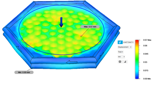

Furthermore, the strain on the floor is extremely low, as shown in the 2nd image. Very few areas on the floor are under even moderate strain, which is reasonable and acceptable in this instance.
Finally, the displacement of the floor is extremely low, with a maximum of 0.07 mm.

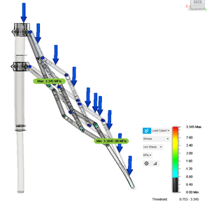

Wait a second! Although the previous simulation is satisfactory for ordinary conditions, the SIMPLAE is specifically designed for extreme environments! With that being said, how does it hold up to an increased weight?
Well, the only environmental condition which will significantly increase the weight the floor experiences is... snow! Although rain might pool on the SIMPLAE, only a certain amount can stick to the sloped roof at a time, making the potential weight small in comparison. So, how much weight would snow really add?
According to CNN, the most snowfall recorded in the world 24 hours is approximately 100.8 inches. According to the Canadian government, "each inch of snow represents a load of about 1 to 1½ pounds per square foot." Using the conservative estimate of 1.5 lbs per square foot per inch, and adding this onto the previous 40 lbs per square foot, this gives a load of 191.2 lbs per sqare foot, or a total load of 43707.36 lbs of force. I rounded this figure up to 45000 lbs, just to be extra safe.
Using this value to create a new simulation, you might be surprised to find that the results hardly even changed! Despite the much larger load, the safety factor actually remained at a stable 15.00! In fact, the only significant change was the displacement, which increased to a maximum of 0.226 mm, which is still very small. Basically, this means that even if there were world record breaking snowfall on top of the SIMPLAE, the floor would still be able to handle the load, easily!
It is worth noting that this result is not actually very realistic, as it assumes that the SIMPLAE is resting on a solid surface. While this is perfectly acceptable for most situations, it does not account for what will happen when the SIMPLAE is floating in water.

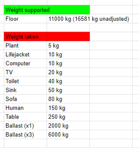

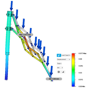

So then, how much weight would the SIMPLAE be able to support on water? Thanks to my physics classes, I've learned that the buoyancy force is equal to -ρvg, where 'ρ' is the density of a fluid, 'v' is the volume displaced, and 'g' is the gravitational constant. Using the "Properties" tool shows that the volume of the floor is 2.119e10 cubic millimeters. Assuming the water is freshwater (since saltwater would give a higher buoyancy force), the equation gives a buoyancy force of 207662 N, meaning that approximately 21190 kg can be supported before sinking. Subtracting the weight of the SIMPLAE itself (4609 kg) gives a carrying load of 16581 kg. However, it is important to assign a carrying load under the maximum physical carrying load, in case of external factors. Thus, we will divide the carrying capacity by 1.5 and round down, to give a maximum carrying capacity of 11000 kg, or 24000 lbs.
This carrying capacity is more than sufficient for our needs, since it can support the 10000 lbs needed for regular use, along with 14000 lbs (~48 inches) of snow. Realistically, it would be almost impossible for 4 feet of snow to accumulate on the SIMPLAE, due to its sloped shape.
But just to make sure, let us inspect what the SIMPLAE can support without sinking, to ensure it is fit for daily use. In the image above, I have made a list of the items that might be used on a SIMPLAE unit.
Image Transcription:
Weight supported: Floor 11000 kg (16581 kg unadjusted)
Weight taken: Plant 5 kg, Lifejacket 10 kg, Computer 10 kg, TV 20 kg, Toilet 40 kg, Sink 50 kg, Sofa 80 kg, Human 150 kg, Table 250 kg, Ballast (x1) 2000 kg, Ballast (x3) 6000 kg
From this chart, it is evident that the buoyancy of the SIMPLAE is more than enough to support its contents. In fact, the buoyancy is so much more than necessary that it might risk becoming unstable, due to floating too high in the water. To counteract this problem, I added ballast bags to the bottom of the floor, as shown in the 2nd image. When the SIMPLAE is floating, the ballast bags will hang down and fill with water, increasing the effective weight and increasing stability. However, when the SIMPLAE is on land, the ballast bags will not get in the way of anything (due to being empty), making them the perfect solution for this issue.
Each ballast bag has a volume of 1.996e9 cubic millimeters, or approximately 2000 kg of water. This means with 3 bags, the carrying load of the SIMPLAE is reduced from 12000 kg to approximately 6000 kg (13000 lbs). This carrying capacity is still more than enough for normal function, while greatly increasing stability. If additional carrying capacity is necessary, the ballast bags can be released remotely.
You might notice from the 2nd image that the three ballast bags are close to the center, rather than on the edges. This might seem odd, since this reduces the torque the ballast bags provide, thus reducing their ability to counteract external forces. However, this design choice comes from the possibility that a ballast bag might be damaged. If this happened with the bags spread apart, the increased torque would work against the SIMPLAE, increasing instability and possibly flipping the entire unit. Placing the bags closer together solves this issue. Similarly, if more than 6000 kg needs to be carried on a single unit, the bags can be released individually, without worry of flipping.

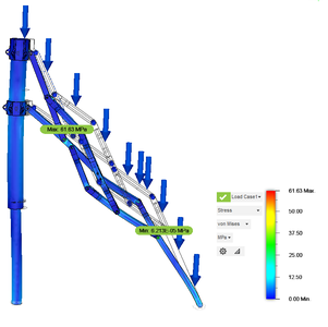

Speaking of which, it is time to begin testing the top half of the SIMPLAE. Since this simulation is made up of multiple components, make sure that you use the "Bolt Connector" tool to connect them together! Note that I am only simulating one of the "arms" of the mechanism, since the arms are all identical.
First, let us first simulate the mechanism under a "normal" load of 40 lbs per square foot. This works out to 185.28 lbs of force, rounded up to 200 lbs. Note that this value is actually overkill, as the mechanism is not meant to support people or furniture. Similar to the floor, the mechanism ends up with a perfect 15.0 safety factors.
As shown in the 1st image, the maximum stress is concentrated around the bolts, which makes sense. These bolts are under 3.345 MPa of stress at the most, which is actually quite a lot. However, since Fusion uses the yield strength (the maximum load before deformation starts) as 207 MPa, this stress is still sufficiently low.
As shown in the 2nd image, the deformation is very small, with a maximum of 0.072 mm.
But what about once snow is added? After experimenting with the values, I found that a load of 4000 lbs would bring the minimum safety factor down to 3.09, which is just above the minimum threshold (3rd image). This translates to ~863 lbs per square foot, or over 540 inches of snow! At 4000 lbs, the stress and displacement both remain reasonable. at ~70 MPa and 1.443 mm respectively. Needless to say, the mechanism is more than strong enough to support the tent.
Something to note is that the only sections of the only sections of the mechanism with a safety factor under 15.0 were the screws: the metal bars are still extremely overengineered! For this reason, this led me to pursue using different, cheaper materials. In particular, aluminum is a strong candidate, for its comparable strength, while weighing around 1/3 of steel! Furthermore, aluminum is cheaper than steel, and it is also a green material, being widely and easily recyclable.
The 4th image shows the mechanism under 4000 lbs of force, using aluminum instead of steel. As you can see, the aluminum bars are still under almost no stress at all. Furthermore, both the safety factor and the displacement are still satisfactory, at ~4.4 and ~3.3 mm respectively, meaning aluminum is the perfect material to build the mechanism from.
With stress testing complete, I was curious as to how the SIMPLAE would react under extreme wind environments. For this, I used Autodesk CFD, which is another Autodesk product that specializes in simulations and fluids. I won't explain how to use CFD here, but this video is by Youtuber 'Shihao' is a great guide on how to get started.
The wind speed that I used was 50 miles per hour, since that is the threshold where structural damage first occurs, according to the national weather service.
As you can see in the 1st image, the majority of the shear stress due to the wind occurs on the sides of the tent, which makes sense. The maximum shear stress is 61.4457 dyne per square centimeter, which is an extremely small amount. Thus, the shear stress due to wind is generally insignificant.
But, how about the stress due to the force of the wind itself? For this, I went back to Fusion, and create a static stress simulation with the load coming from the side. This would simulate the force caused by wind pushing against the SIMPLAE mechanism.
According to the Arizona State University, the fastest wind speed ever recorded was 231 mph. This translates to approximately 140 lbs per square foot, or ~700 lbs of force on each mechanism arm.
As shown in the 2nd image, under these conditions, the arm still has a minimum safety factor of 6.131, which is well within acceptable limits. Furthermore, the maximum stress and displacement are both acceptable, being 44.9 MPa and 2.12 mm respectively. Thus, the mechanism can withstand extremely strong winds.
Just to make sure, I also ran some more simulations with the force coming from different directions. I have recorded the results below.
  • 90 degrees X, 0 degrees Y, 0 degrees Z: Min. safety 6.13, Max. stress 44.9 MPa, Max. displacement 2.12 mm
  • 90 degrees X, 45 degrees Y, 0 degrees Z: Min. safety 6.64, Max. stress 41.4 MPa, Max. displacement 9.08 mm
  • 60 degrees X, 0 degrees Y, 0 degrees Z: Min. safety 7.06, Max. stress 38.9 MPa, Max. displacement 2.07 mm
  • 60 degrees X, 45 degrees Y, 0 degrees Z: Min. safety 6.06, Max. stress 45.4 MPa, Max. displacement 10.4 mm
  • 30 degrees X, 0 degrees Y, 0 degrees Z: Min. safety 9.56, Max. stress 28.8 MPa, Max. displacement 1.74 mm
  • 30 degrees X, 45 degrees Y, 0 degrees Z: Min. safety 7.20, Max. stress 38.2, Max. displacement 8.96 mm
  • 100 degrees X, 0 degrees Y, 0 degrees Z: Min. safety 6.10, Max. stress 45.1, Max. displacement 2.32 mm
  • 100 degrees X, 45 degrees Y, 0 degrees Z: Min. safety 7.23, Max. stress 38.0 MPa, Max. displacement 8.05 mm
As you can see, all of these values result in acceptable values.

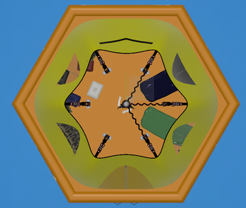

Inside the single family temporary shelter, there are two private sleeping areas, partitioned using curtains. The rest of the SIMPLAE is dedicated to food, storage, and recreation. There are also two batteries on the central pole, linked up to the solar panels. Although this model might seem sparse, this is only a baseplate with all the necessary items for living, and further decoration can depend on the inhabitants.
Note the window to the outside on the left. It is not very visible in this image, but the image I used for the background is from the aftermath of an earthquake in Japan, which is a scenario where this setup might be used.
From this perspective, the door to exit the SIMPLAE is behind the camera.

Another potential use of the SIMPLAE is to give disaster relief workers a place to work out of, so they can monitor the situation and find and help rescues faster. In this CAD, I have modeled what this might look like in real life.
The 1st image shows the exterior, bird's-eye view of the base. The 2nd image shows the interior as well. This is only to give an overview, and the model will be explored in further depth below, as there are many details not visible in this view. The legend corresponding to the images is:
  1. Washroom + Water Treatment
  2. Medical Room
  3. Common Room
  4. Dock
  5. Work Room
  6. Break Room
  7. Solar Panels
  8. Ropes, to tie the SIMPLAE together
The doors are difficult to see in these images, so I also drew a red door on all the doors.
Here are some things to note about this design:
  • The base is made in a triangular design. This is to ensure stability, so that the base will not easily tip. This also minimizes the surface area exposed to the outside, decreasing the chance of punctures or getting stuck on something.
  • The medical room is directly next to the dock, for faster access. For the same reason, the bathroom is also right next to the medical room.
  • Every room has at least 2 exits, in case of emergencies. If all main exits are blocked, the windows are also large enough to escape from.
  • There are always four ropes connecting the rooms together, for redundancy.
  • The 1st tent (the washroom) is split into 3 different "rooms", using curtains. This allows for 2 washrooms and a storage room within a single SIMPLAE unit.
  • Though not very visible in this image, there are curtains across the entrance to the bathrooms, for privacy.
  • This base is NOT meant to accommodate rescues from natural disasters. It is primarily intended for workers to monitor and coordinate rescue efforts, and it can only temporarily hold rescues until suitable habitation can be found (the individual SIMPLAEs, as previously shown).
  • To that effect, the medical room is not intended as a full hospital, as it lacks many necessities. Instead, it can only give basic treatments, and temporarily hold patients until better care is found.
  • This build is based off of the conditions in the 2023 Beijing-Tianjin-Hebei Heavy rain flooding. For this reason, the solar panels are angled towards the south-east and south-west, to get the most sunlight. This also means the solar panels will generate power at all times of day. For different locations, simply rotate the base in different directions.

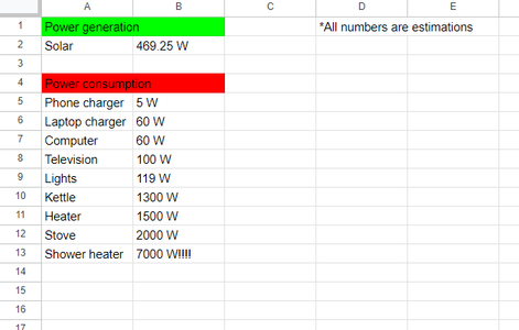

The primary method of generating power in the SIMPALE is solar panels, as shown in the previous chapter. But how much energy can the SIMPLAE handle from the solar panels alone?
According to University of Michigan, commercial solar panels have an average efficiency of around 20%. According to a research group, the average solar irradiance (the amount of sunlight a place receives) in Beijing is approximately 1241 kWhm^-2. The total solar panel surface area on a single SIMPLAE unit is 1955200 mm^2. Thus, the math works out to approximately 469.25 watts per unit.
But how much energy does the SIMPLAE use? According to Mega Plus Synergy, a single LED bulb at 1100 lumens draws 17 watts. Each SIMPLAE comes with 6 lights, so the lights use 102 watts. There is also a digital display on the battery of each SIMPLAE, so we will increase that to 119 watts.
Assuming no other use, this means that over 300 watts are going unused, which is much more than enough to be safe. However, there are many activities which might require more electricity, which is why I have created the chart in the 1st image.
Image transcription:
Power generation: Solar 469.25 W
Power consumption: Phone charger 5 W, Laptop charger 60 W, Computer 60 W, Television 100 W, Lights 119 W, Kettle 1300 W, Heater 1500 W, Stove 2000 W, Shower heater 7000W!!!!
As you can see, under ordinary use, the power generation is more than enough -- the 4 solar panels can handle several phone and laptop chargers. However, many first-world conveniences we are used to, such as kettles and hot showers, take too much for the solar panels alone to support. I was especially surprised by the amount of power that shower heaters need. I should take shorter showers.
Luckily, when power is desperately needed (such as for heaters in cold environments), the SIMPLAE comes equipped with a fully charged battery. This battery can be recharged using solar panels, other power sources, or even just replaced with a new battery. That is also how the SIMPLAE provides power through the night, or when the sun is blocked.
So to summarize, how did the SIMPLAE do on power? Here are my thoughts:
  • For its most important use case (disaster relief), the SIMPLAE generally provides more than enough power, and surpasses its goal.
  • The power generation is also sufficient for most other use-cases, such as research and exploration.
  • However, the power has one glaring flaw: cold environments! Especially in places where it can go for months without sunlight, such as the arctic, the solar panels struggle to reach the power needed for most heaters. Even with proper insulation meaning minimal heat loss, the majority of the SIMPLAE's power consumption will be taken up by heating.
  • In such cases, alternative power generation will need to be used, or extra batteries will need to be shipped. Alternative methods for power are usually sparse in cold environments, meaning batteries will likely be used. This is regrettable, as it reduces the longevity of the SIMPLAE, and increases the environmental footprint.

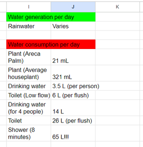

The only source of water in the SIMPLAE is the rainwater catcher, installed on the exterior. The efficacy of this source will vary widely, depending on the amount of rain. In Beijing, the amount of rainfall is likely sufficient to sustain ~4 people, since there is a moderate to heavy amount of rain in July. It is worth noting again that rainwater is generally NOT safe to drink, and it always needs to be filtered first to be safe.
Furthermore, drinking is not the only usage for water. In the first image is a list of how much water different activities require.
Water generation per day: Rainwater Varies
Water consumption per day: Plant (Areca Palm) 21 mL, Plant (Average houseplant) 321 mL, Drinking water 3.5 L (per person), Toilet (low flow) 6 L per flush, Drinking water (for 4 people) 14 L, Toilet 26 L per flush, Shower (8 minutes) 65 L!!!
Once again, I need to take shorter showers.... So to summarize, how did the SIMPLAE do on water? Here are my thoughts:

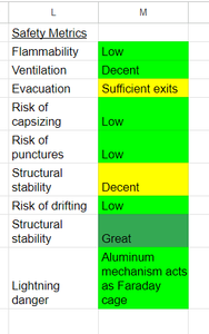

Step 31: Safety
The SIMPLAE was initially designed with safety in mind, in order to reduce human labour in extreme environments. But how did it really do? Here are my thoughts:
  • Being able to inflate and expand without human intervention is extremely valuable, especially in unsafe environments. It also reduces the difficulty in construction, and the possibility of error, as most people do not know how to construct their own habitation. The SIMPLAE excels in this regard.
  • However, some of the additional, optional parts might be difficult for humans to install. Notably, the solar panels are high up and difficult to reach. But, if the environment is truly making it dangerous to install solar panels on top of the unit, alternative methods can be used, such as inflating another "dock" with solar panels on the floor.
  • Another difficult to install aspect would be the "bridges" connecting the units together. However, due to the redundancy in the 4 ropes connecting the units, the danger is minimized.
  • The windows of the SIMPLAE are deliberately made quite large and low, and fully openable. This serves as an alternate escape method, in case all exits are blocked. However, this can still be difficult and dangerous for immobile, young, or elderly persons. This issue can be minimized by ensuring every SIMPLAE unit has at least two accessible exits in larger structures.
  • As evidenced in Chapter 3, the structural stability of the SIMPLAE is more than satisfactory. Furthermore, the materials used in construction were deliberately selected for safety: for example, PVC is highly puncture resistant and highly abrasion resistant, minimizing the danger of deflation.
  • In the case that deflation does occur, the "floor" of the SIMPLAE is equipped with 2 separate gas chambers (as per the Canadian maritime safety requirements) meaning a single one deflating will not lead to sinking. If a chamber is punctured, the unit can be evacuated before any further punctures.
  • In summary, the SIMPALE excels in safety.
