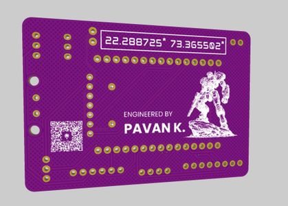

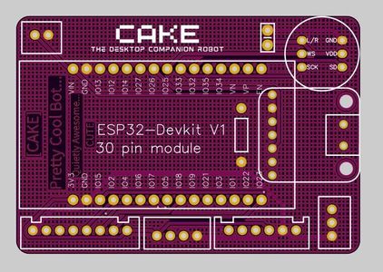

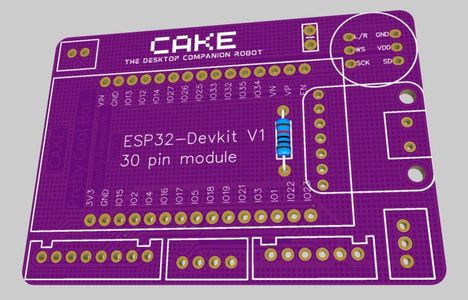

Step 3: Order the Custom PCB
While you can build CAKE using point-to-point wiring, the custom PCB dramatically simplifies assembly and increases reliability. The PCB handles all the complex interconnections between components and includes mounting points perfectly matched to the 3D printed chassis.
PCB Specifications
  1. Layers: 2-layer board
  2. Dimensions: 60mm × 40mm
  3. Thickness: 1.6mm standard
  4. Finish: HASL or ENIG (either works fine)
Ordering Process
  1. JUST find the gerber file form my github
  2. Upload to your preferred PCB manufacturer (PCBWay, JLCPCB, etc.)
  3. Select quantity (3-5 recommended in case of mistakes)
  4. Choose standard options (2-layer, 1.6mm, etc.)
  5. Total cost is typically around $5-10 plus shipping
Money-Saving Tip: Many PCB manufacturers offer first-time customer discounts. Also consider bundling with other projects to save on shipping!

  8. Mount speaker, mic, OLED, Neopixel, and ADPS to ESP32
  9. Power ESP32 (2) via regulated 5V from the buck converter
  10. Install the battery and toggle switch
  11. Optional: wire headphone jack for alternate audio output
  12. I had attached schematics of pcb.
PFA: A detailed connection table is available in the GITHUB repo
