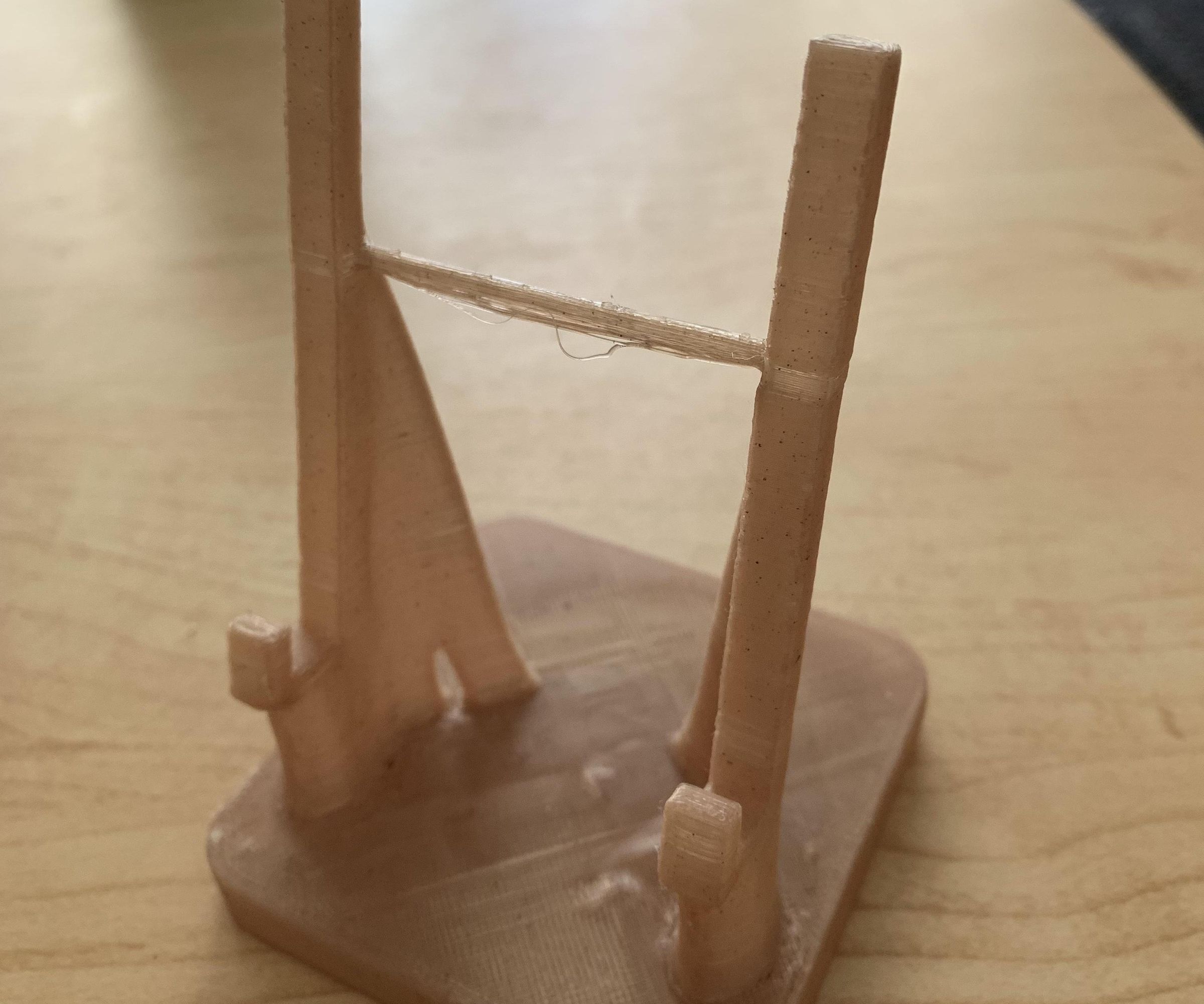

For this week of assignment in MAT594X, I try to create toolpaths for a milling machine to create a iPhone holder. The library used for CNC simulation is the Autodesk Pier 9 CNC tool library in Fusion 360.
