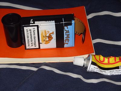

Step 6: Glueing Film Containers
This step, is simple.
Take the two cutted film containers and glue, i've used silicon glue, to the side of the pack.
Pay attention that the cut is parallel and at the same level of the side of the pack, so the film remain straight. After that wait until the glue drie.
