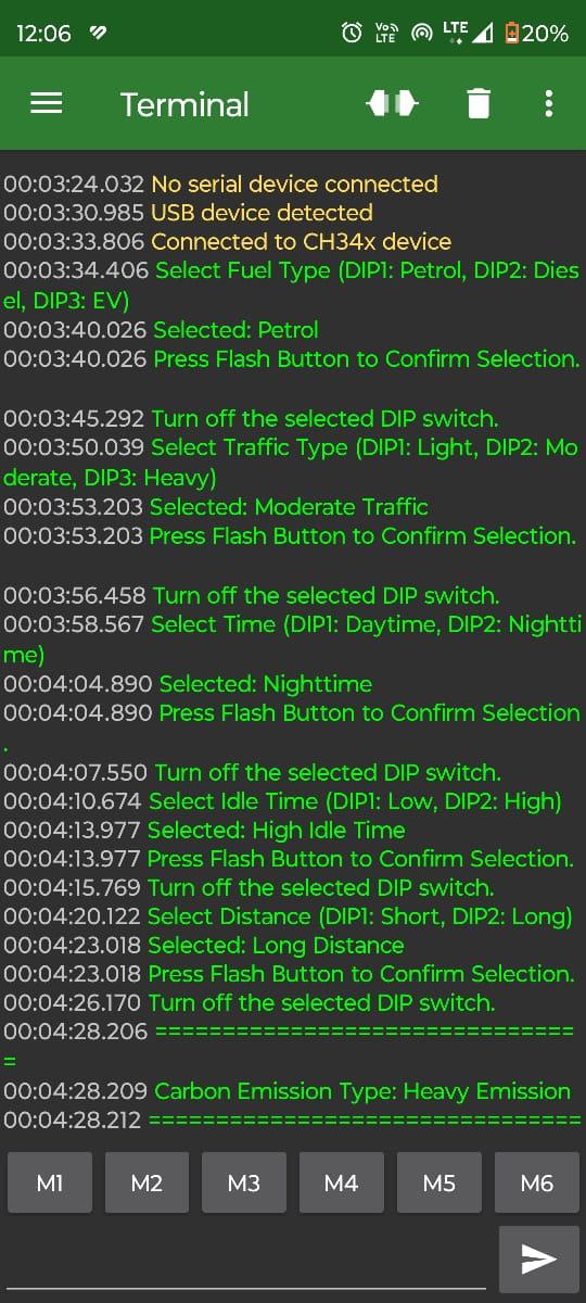

Open the code in Arduino IDE and flash into the esp8266 and edit the section with the wifi ssid and password to your wifi and the ip of the remote server or the url of the cloud server should be added in the code before flashing
connect a laptop or a mobile phone and use some software to read serial data and get the question and use the DIP switches to get the output
