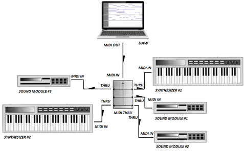

First thing first: What a MIDI THRU Box is?A MIDI THRU box is a device capable of receiveing MIDI data streams and duplicate them by "n", with "n" the number of outputs. If you try to send a MIDI OUT data to more than one device directly, the signal will degrade and soon will loose it's information. A MIDI THRU box keeps the signal "alive" and "the same" for all connected MIDI devices.
How can a THRU Box be used?Consider you have more than one MIDI instrument (synthesizer, drum machine, rack effect...), that you want to syncronize and automate: how could you send them MIDI messages from your single DAW's MIDI OUT at the same time? The answer is simple: with a MIDI THRU box! See attached picture for a basic MIDI setup.

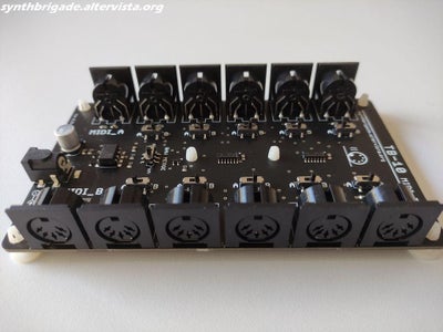

As said, I wanted to keep the number of THRUs at a minimum level of "eight" (ended up with ten!). Such an extended number of MIDI THRU ports calls for a larger number of boundary components. This made me think that the best approach would be to rely on Surface Mount Devices (SMDs). This was the first time for me (I am used to THT - Through Hole Technology - parts, easier to handle and socket mountable) but given the fact that it's nowadays possibile to have PCBs not only manufactured but also assembled at low cost, made me feel more confident.
My intention was to develop a THRU box for studio use, not for gigging. This made me left out the possibility to run on batteries. Also, being that such circuit can be layed down with logic circuits only, I preferred to rely on a regulated +5V dc power adapter instead of the +9V dc the original TB-1 had. This averall made the box more efficient from a power consumption point of view (remember: those 4(V) * current(A) would be dissipated as heat) and left more PCB space free because of the lack of the onboard power regulation circuit.
One geometrical feature the TB-1 had was having all the MIDI connectors on the same side. Ten MIDI DIN connectors (twelve in the final design, see later) on the same side would call for a very long PCB. Considering that I wanted to realize a stand alone PCB (no box), such an elongated aspect ratio would lead to an unstable device that could topple over. I then preferred to place MIDI connectors on both sides, similarly to what Yamaha did with the YME8 MIDI THRU box.
I also wanted to add a feature not seen in any other MIDI THRU: the possibility to route both MIDI IN messages to all outputs at the same time. Sort of merging, but without the use of a microcontroller (remember the lag issue I pointed out before?).
Why no-one has made it before? Well likely because it's a feature you must use with a grain of salt. This "merging" would work with non-simultaneous MIDI messages only. In the case of simultaneous transmission, the resulting output would be corrupted and not interpretable by the receiving device. This could not be a big trouble if only trigger-in-nature MIDI messages are sent (i.e. MIDI note-on and MIDI note-off), but what if a continuous and high frequency MIDI message like clock enters the MIDI THRU circuit with the merge feature engaged? Any MIDI data stream would be corrupted... MIDI clock included!
Why did you include this feature then? I can see some use for it. In example, if you have two MIDI devices you frequently use to record MIDI events in your DAW (master clock) and you want to be able to record with both of them (alternatively) without connecting and disconnecting MIDI cables or sliding the TB-10 MIDI input select switch every time you move from one to the other, this would definitely come handy. These MIDI devices could be, but are not limited to, a master keyboard and a drum pad, or two master keyboards with different action.
This is why I called this mode of operation "Raw Merge" and must be used with a grain of salt when engaged via the dedicated switch :)
Please notice that when this feature is engaged, "merged" MIDI messages will be sent to all MIDI connectors despite the position of the source selector switch.

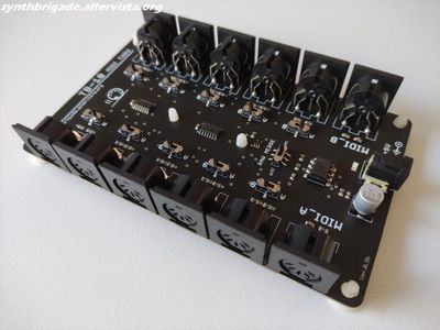

This project uses mostly surface mount devices, with the exception of MIDI DIN-5 connectors. This was my first experience with an SMD design and I have to admit that, because of my lack of confidence, I revisited this decision more than once before "pulling the trigger".
I gave JLCPCB SMT assembly service a try and I must say that having everything ready was easier than I thought. It's inevitably more articulated than dealing with THT parts only (you have to upload not only your zipped Gerber files, but also BOM and CPL files, select the components between those available and make some accurate visual checking before being done), but with the help of THESE instructions and the online submission form everything went smooth and well.
I took some notes about the "criticalities" I found during this first experience with SMD assembly. I also noted solutions, for my (and your) future use:
  • If you are running on an old PCB design software version, use the correct exporter file. I had to use "jlcpcb_smta_exporter_v7.ulp" instead of "jlcpcb_smta_exporter.ulp" for the CPL and BOM files generation.
  • Parts without a value could be left out by the ULP, depending on your choice. Be sure to uncheck "skip parts with missing values" if present.
  • Components selection is kept in memory and next time your choices will be used automatically. This speeds up the whole process, especially when a board's layout last-second update forces you to re-upload all the files.
  • After the Gerber, BOM and CPL files are uploaded, a representation of the board will be displayed for a first components positions check. It is possible that some IC has the wrong orientation and is a little misplaced at this time (see attached picture, left board). No problem!JLCPCB engineers review and take care of components positions and orientations for you before the assembly! Continue with your order: they will contact you before assembly if criticalities in components placement and orientation are present.
  • The board representation screen is a good place to check for missing components (see also point #2 of this list). Carefully go though all the board, be sure that all components are there (no matter their exact position and orientation, as said) and go back if something is missing.
  • Components selection is the most important (and funniest, in my opinion) phase. If the automatic selected part is not available or in inventory shortage, do not desperate! Use a more generic term in the part research field. In example: use 74HC14 instead of CD74HC14M and more options will be at your disposal.
