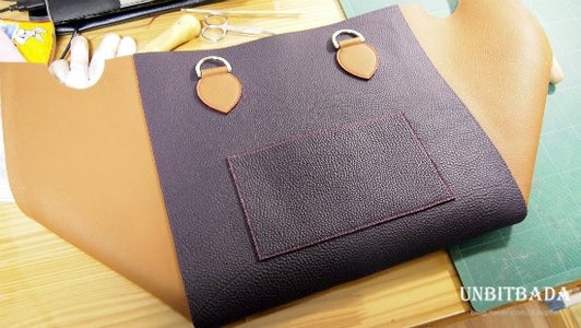

Step 4: Make a Loop Handle.
1. Prepare four 3cm D-rings to attach the front plate and the back plate ready to leather.
2. Connect the D-rings and leathers as the picture.
3. Finish to the edge coat.
Step 5: Fix That You Created in Step 4
1. Displays a silver pen with a fixed position of the front plate and the back plate made in step 4.
2. Makes it easy to scrape with sandpapers bonding position shown in (1).
3. Apply the adhesive evenly on parts made from parts in step 4 and (2), and dried.
4. Meticulously attached by a roller.
5. Makes the stitching holes with an awl or a griff.
6. Stitching.
6. Stitching.
