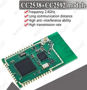

For this reason the Zigbee2MQTT developers added support for CC1352P / 2CC26X2R1 chips also. These chips have got a lot bigger price tag, but luckily another cheaper alternative showed up: the CC2538! It has 32kB memory and powered by an ARM M3 MCU.

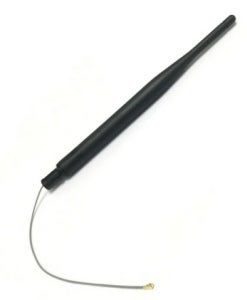

The module has IPEX connector for external antenna, and an integrated antenna also, it can be changed by soldering a little SMD resistor, which defaults to the external antenna. For better range use an external antenna.

  • 2.4Ghz antenna with IPEX connector (2 USD)

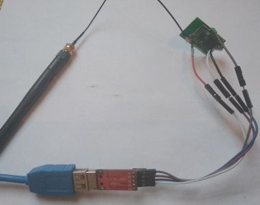

Step 1: Wiring & Pinout for Programming
There are several modules with different pin layouts, so be sure to check the module you bought. Distance is 1.27mm in between the pins, so steady hand and good eye needed for soldering.
The following connections needs to be created between the programmer and the CC2538:
Programmer --- CC2538
TX --- PA0 (RX)
RX --- PA1 (TX)
GND --- GND
VCC 3V3 --- VDD
If you are using the modified Modkamru firmware (by MadDoct, link at next step) and at a later time a firmware refresh is needed the PA7 pin needs to be connected to GND, it will start the serial bootloader, so it is a wise idea to solder a pin/cable to PA7 also. (Thanks for informations to MadDoct!)
*Be advised that CC2538 are rated 175mA consumption (at max transmitting power) but the CP2102 can only supply 100mA, so it will work for programming, but may be insufficient for normal use.

Connect the USB programmer to the PC and check if the connection works: (/dev/ttyUSB0 is the CP2102 address in the Linux system, you can check it with dmesg | tail after connecting it)
sudo python3 cc2538-bsl.py -p /dev/ttyUSB0
The reply has to be something like this:
Opening port /dev/ttyUSB0, baud 500000
Connecting to target... CC2538 PG2.0: 512KB Flash, 32KB SRAM, CCFG at 0x0027FFD4
Primary IEEE Address: 00:12:4B:00:06:0E:4B:FB

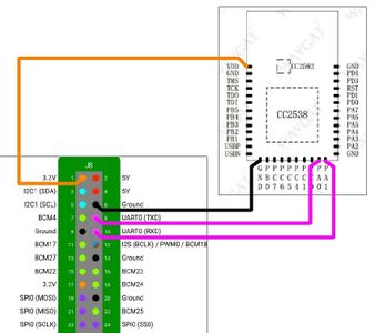

To use it, you need a small, Linux capable SingleBoardComputer with serial connection, for example a Raspberry PI Zero W. The RPI has an integrated PAM2306 1A DC-DC converter, maybe half of it used by onboard devices but the remaining ~500mA (3V3) power is more than enough for the CC2358 to operate normally.
Wiring for Raspberry Pi:
RPI --- CC2538
TX --- PA0 (RX)
RX --- PA1 (TX)
GND --- GND
VCC 3V3 --- VDD

  • Do not forget to enable onboard serial port and disable serial kernel logging (raspi-config)
  • For RPI Zero, RPI3 and newer versions with integrated Bluetooth, you have to disable Bluetooth first if you want to use integrated serial (serial vs ble)
  • In Zigbee2MQTT configuration.yaml set rtscts: false otherwise the communication will never be started
