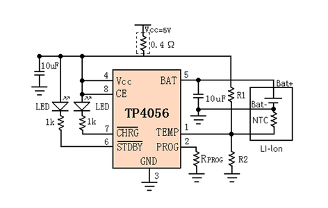

Step 3: How the Charging IC Works:
As per the battery voltage, the IC pulled in one of the above-given 3 modes. The current is controlled through an external programmable resistor, which just applies a restriction to the maximum current. IC’s like TP4056 limit the charge current based on die temperature during high power operation or high ambient temperature.
In the case of lithium ions, the charge voltage is fixed at 4.2V. Automatically terminates the charge cycle when the charge current drops to 1/10th of the programmed value after reaching the final float voltage. Other features of a battery PMIC include a cell temperature monitor, under-voltage lockout, automatic recharge, and two LED status indication pins for charge termination and presence of an input voltage. The basic diagram of TP 4056 is follows.

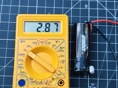

All we need is a discharged battery, some multimeters, an electronic power supply with a current control function, and a variable electronic load. To replicate the charging behaviour properly, I discharged the battery to some extent using an electronic load, which we made previously. See the full build here.

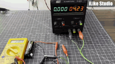

Step 6: SET THE POWER SUPPLY
Step 1: Set the voltage of the power supply to 4.20 volts.
Step 2: Set the maximum current output to 1A. This can be done by directly shorting the pins of the power supply and then turning the current control knob. If you don’t have this feature, use a multimeter and a low-resistance load to set the value to 1A. For this, your power supply must have a current controlling knob. (See the GIF)
Step 7: Battery Selection and Connection
Step 3: Now we have 4.2V and amax current limit of 1A. The battery I have here is rated 3C, 2000mAh, with max discharge current and charge current of 6A. But I have limited the max charging current to 1A for safety and to avoid heating issues.

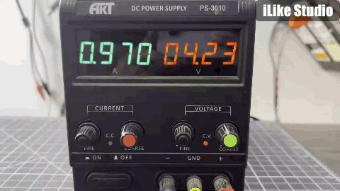

Step 4: Connect the battery to the power supply, and you will see that the current will be limited to 1A. It will charge in CC mode, my battery can take 6A charging current, so it charges 6x slower. The GIF shows how the battery voltage increase while charging.
Step 8: CC TO CV SHIFT

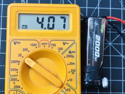

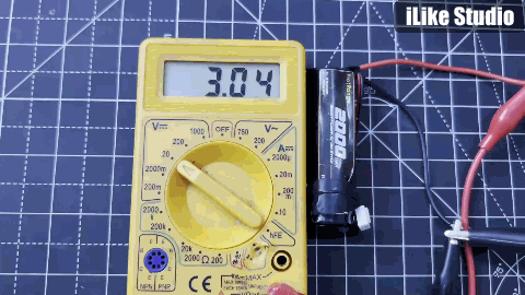

Step 5: Monitor the battery voltage and current, as the battery voltage keeps increasing, lesser current will be drawn. A point came where the battery draws exactly 1A current. This is the point where battery charging shifts from CC to CV mode. And as said earlier, one thing is constant, either voltage or current, so see the GIF, when the power supply is connected to the battery, its voltage drops to 3 volts and the current flows of 980mA.
Step 9: Charge Completion
Step 6: Now, in the CV, we have already set the max voltage to 4.20V. It can be set using a power supply or an external voltage regulator. So the battery voltage now maximises to 4.10 to 4.15 and charges in constant voltage mode, in which the current slowly comes down from 1A to 0A. And 0A shows that the battery is fully charged. A GIF shows how the current is decreasing from 1A to 0, with time as the battery charges.
