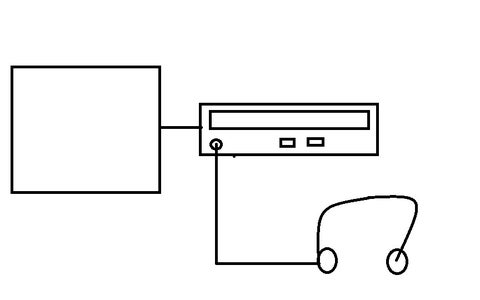

Power supply's need to receive a signal from a motherboard in order to turn on, but we don't have, or want to get a motherboard just to turn this darn thing on! So we will trick it into thinking the motherboard is telling it to turn on. We do this by inserting a paper clip, or some wiring into what we will call "The Communication Cable". There will be a series of holes in the connecter for this cable with various wires coming out the bottom. What we need to do is insert the paper clip or other wiring into the hole the green cable comes up to, and any hole a black cable comes up to. (on a side notice, in the photo the power supply has been opened. i did this to clean the fan but i would not advise it due to shocking risk.)
Step 2: Wiring
Now we will connect everything together. The Basic Concept we will be working off of is shown in the photos. Plug one of the power cables from the power supply into the CDROM drive, then plug in your headphones. To top it all off, plug in the power-supply. If you have it correctly hot-wirred with the paper clip it should start right up. just press play and listen away!
