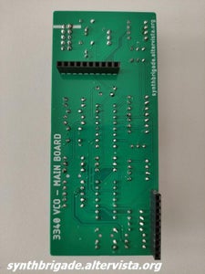

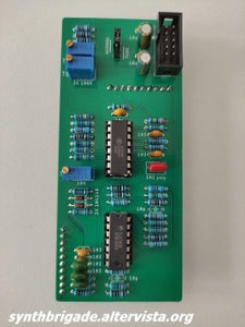

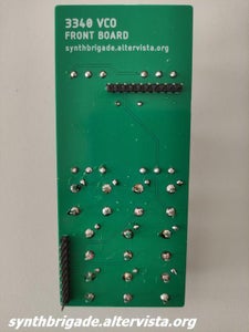

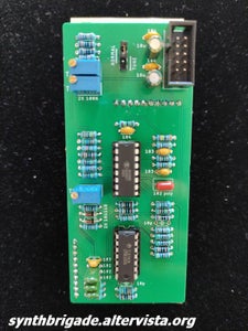

In this Instructables I will show you my optimized Eurorack analog oscillator module based on CEM3340. I will share with you all the files needed to have the PCBs manufactured (Gerbers) and have it ready waaaay faster than on perfboard ;)

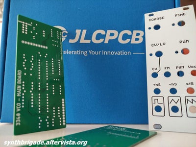

This module is made of three boards. One is the face plate and has no components. The other two (main board and front board) have to be populated.

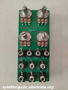

Front Board
Resistors
4x 100K ohm potentiometer (WH148)
1X 20K ohm resistor
Others
2x 10 pin header, male
10x PJ301M Female MONO Jack Connector 3.5 mm

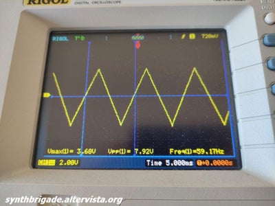

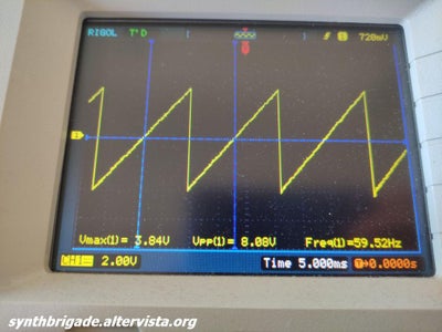

One thing to notice is that each waveform output on the CEM3340 has a different amplitude. Sawtooth is 2/3 of the positive supply voltage, triangle is 1/3 of the positive supply voltage and square/pulse is equal to positive supply voltage minus 1.5V. For example, with a +12V power supply, the (maximum) output levels would be 8V for sawtooth, 4V for triangle and 10.5V for square.
Since these amplitudes are not uniform, it is common practice to use operational amplifier circuits to balance the levels at the final stage.
The square/pulse output has the additional quirk of being an open-collector output, meaning it requires an external pull-down resistor tied to ground to set the low level (nothing difficult to handle, but good to know!).
Waves out of the CEM3340 are positive biased, this means that they oscillate in positive voltage domain. This is not in line with eurorack standards.

The PCB I layed down has all the CEM3340 features made available: frequency control (coarse and fine), three independent waves outs, soft and hard sync inputs, a main control voltage for V/oct input, a secondary, attenuated, linear control voltage input, FM input and pulse wave width control over modulation (PWM).
As I wrote in the previous Step, one point that deserves attention is that CEM3340 outputs positively biased waveforms, but Eurorack standard calls for unbiased oscillators. In my first iteration of the module I used decoupling capacitors in series with the outputs (a very common way to decouple audio signals), but this can lead to high pass filtering, to some extent. To keep the wave as "pure" as possible, this time I preferred to play with the output stage and operational amplifiers configuration, in a way similar to how Kassutronics did in his design.
These same output stages are in charge to amplify the waves coming from the IC. Here I cheated the Eurorack standard a little bit, keeping outputs in the 8-9Vpp ballpark instead of 10Vpp (who needs 10Vpp on audio waveform?).
>>HERE<< a Falstad simulation of one of the final stages I used.
With respect to my first module version I left out the attenuation stage for FM input. This way the oscillator module's dimension could stay whithin the 10HP. Not bad for a full-featured, CEM3340 based oscillator module!
An attenuation stage for FM, if necessary, can be easily added with an attenuator external module.
The moudle calls for dual rail supply (+12V and -12V). Suppply voltages are smoothed through capacitors as soon as they hit the module.
The CEM3340 eurorack module is made of three boards: a main board hosting most of the circuits, a front board with potentiometers and in/out jacks, and a panel "plate" board.
The panel board has no traces and should be made out of aluminum alloy, not FR4, for maximum strenght. Boards are intended to be stacked one over each other and are put into electrical comunication through male/female pinheaders.
Components values are directly silkscreened on the PCB, which makes the assembly way easier than consulting a reference sheet.

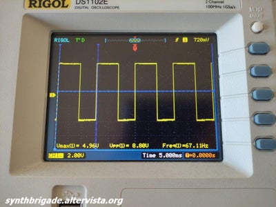

Warning #1: the IC goes into the ultrasound realm with ease. Do not use valued speakers to tune the oscillator or you run the risk to damage them. Use earphones, but do not wear them (your ears are even more valued).
Warning #2: the oscillator output is HOT (8-9Vpp). Use an attenuator before hitting a line mixer desk, or you will likely damage it.

Many thanks to the nice girls and guys at JLCPCB for sponsoring this module's PCBs. Without their contribution this project would have never reached it's actual level of developent.
