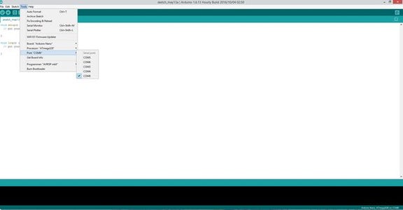

Step 1: Check the COM Ports
If you open that Arduino IDE or LittleArm GUI you should now be able to see an Additional COM port listed in your USB options.
That is all there is to it.
