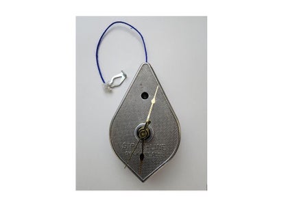

I wanted a clock - something different in my new workshop. So, I came up with the idea of using a chalk line reel to hold and display a clock.

Really just plain luck, the quartz clock I bought was a great fit, only needed a few minor modifications to the clock and the reel.
I placed the clock in the reel and marked in silver where material needed to be removed from the plastic body.
I notice on the metal reel housing that there was a tab sticking up by the chalk door. This needed to be removed, so I marked it with a black marker.
Step 3: Modify of the Clock
To get the clock to drop in - I needed to modify the plastic clock body.
I used a small backsaw to cut the corners (as marked) off the plastic body of the clock edges near the battery box. It worked out that I did not need to cut the battery terminals. I am also glad that I did not need to cut into the main part of the clock.
The output shaft of the clock - centered into the reel crank handle hole (I am going to use the word luck here again).
Please note I did not measure - I just estimated how much material to remove.

Step 7: Assemble Clock Hands and Put Two Halves Together
I followed the instructions to assemble the clock hands (as noted in the image)
  • Put the aa battery in.
  • put the chalk door in
  • made sure the string was position out the top of the metal reel housing
  • then closed both halves together
  • I put the the two screws in and tighten (I did not over tighten)
Step 8: Clock Can Be Hung by a Nail or on an Edge
Using a nail with hammer - I put it in a location that I will enjoy and see the clock.
I left the original clip on the end of the string which allows it to hang off of an edge if needed.

I posted an image of my dads clock that he made perhaps for another idea.
