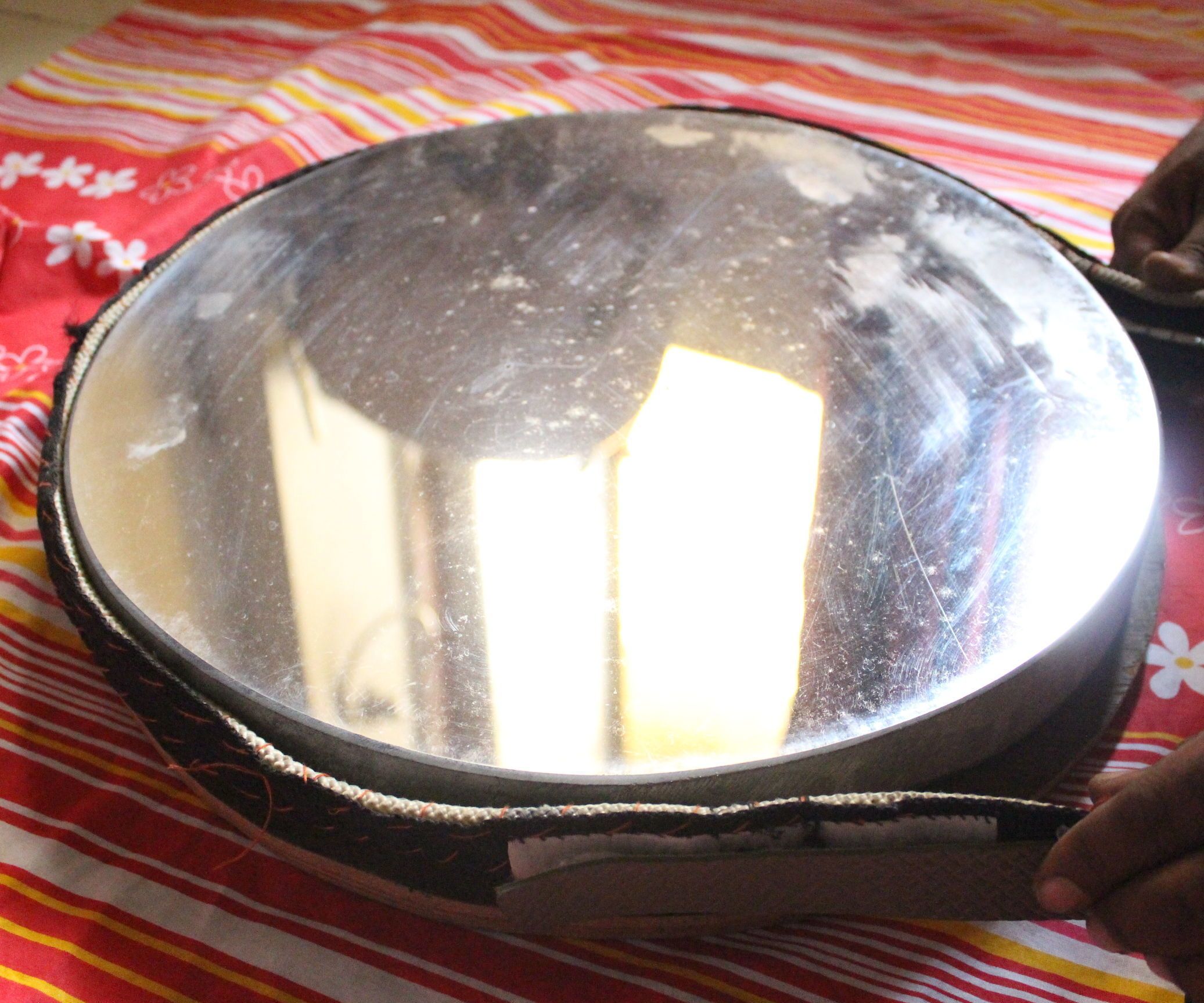

· One beam directed at right angle, should focus the test mirror. if your test mirror is flat mirror you can keep it close to the splitter beam. If you want to test primary mirror it has to be kept at radius of curvature(ROC).
NOTE: ROC IS CALCULATED AS TWICE THE FOCAL LENGTH. ROC CAN BE MEASURED BY FOCUSING A TORCH IN FRONT OF THE MIRROR AND TRY TO GET THE SHARP FOCUS IN FRONT OF THE TORCH.
