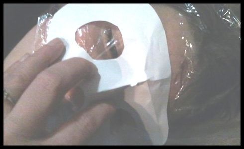

Place the plastic wrap over half the face to the top of the upper lip
I only focused on getting the facial features right, not worrying about the sides of the mask at this point.
Position the mask on the model
Once I got a good coat of white glue around the eyes, nose and brows I started forming and folding where it was needed - focus on the bone shapes of the face - try to get a nice curve on the cheeks, brows, nose and forehead areas - Get your fingers in it so you can feel the bone shape of the face
