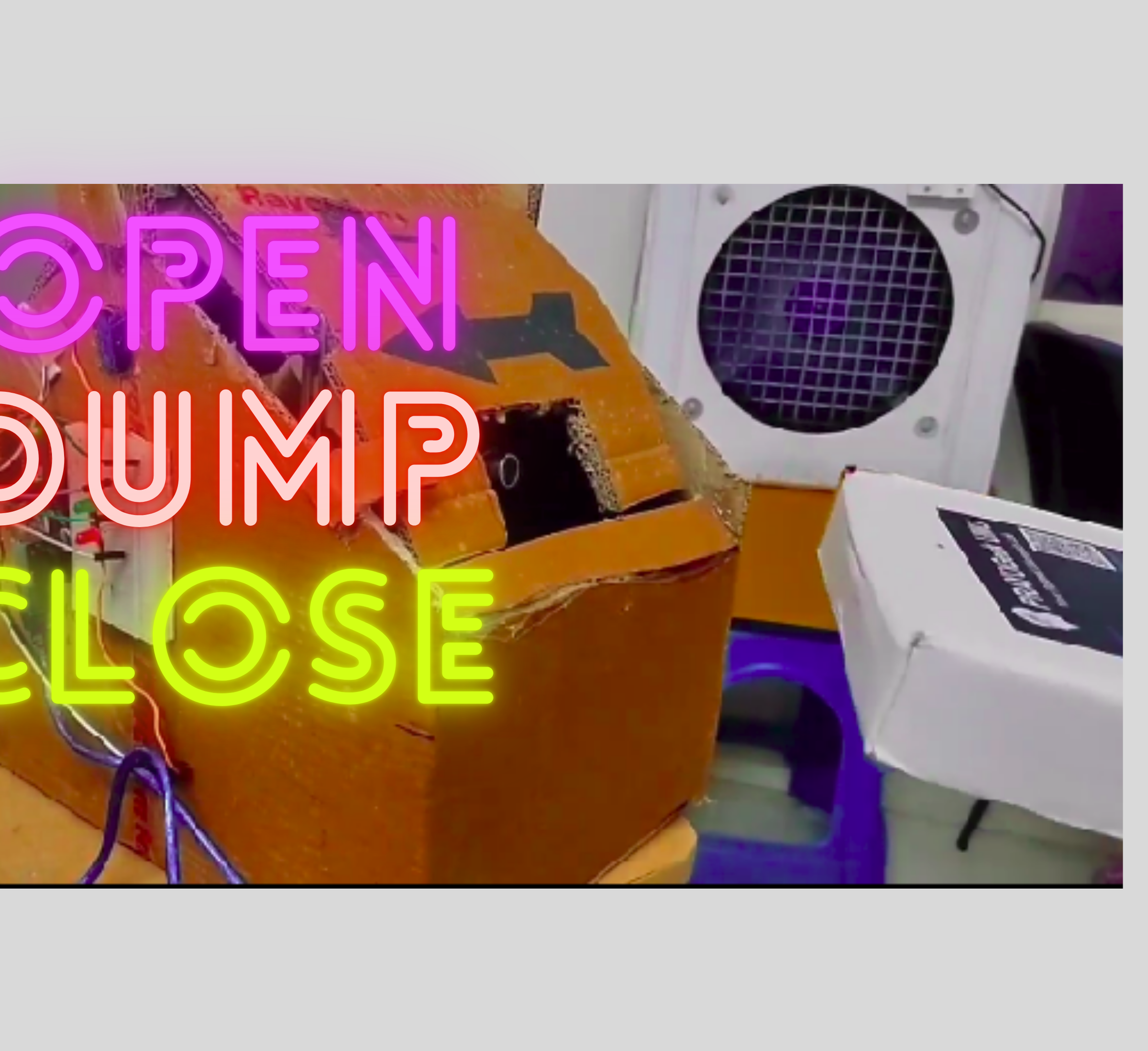

Step 2: Chiku 1.0: Under Process
I constructed a dedicated structure to facilitate the development of an obstacle avoidance algorithm using the Machanix platform. To enable dynamic movement, I engineered a straightforward yet effective pan-joint mechanism. This arrangement allowed me to mount an ultrasonic sensor, which I positioned atop the pan joint.
Initially, I executed sensor rotation algorithm which is basically a combination of measurement algorithm with servo sweep algorithm along the yaw axis, enabling me to gather readings through meticulous distance measurement coding. This custom measurement code was meticulously developed based on a reference YouTube video by DroneBot Workshop, ensuring precision and accuracy in the distance measurement process. This iterative approach facilitated the systematic refinement of the obstacle avoidance algorithm.

Step 5: Chiku 1.0:Completed
Hardware:
During the lockdown, I crafted the robot using everyday items and the Machanix platform. For the robot's design, you can follow a similar approach by finding a 3-wheeled front steering design online or creating your own, as I did.
I used a steering wheel positioned just below the pan joint, with its movements controlled by a servo motor. This allowed the robot to have precise control over its direction.
For the circuit, it's pretty straightforward, as shown in one of the above images.
