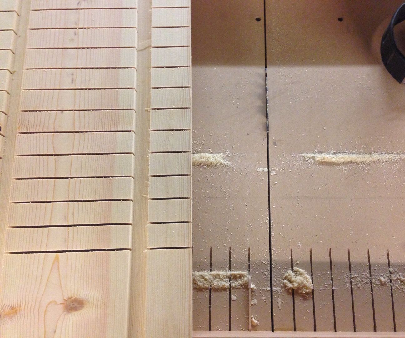

Step 7: Lever Panels
While the curved panels are extremely appealing, they are an aesthetic choice. You can make any kind of panel you want. For instance: a flat board that can be upholstered or reinforced cardboard.
Here’s how I made the panels for CHIME SF though…and I'm sure there is a better way to do this.
6ft, 1”x12” pine boards (the good ones- they’re straighter and have a decent finish with little surface prep needed.)
2, ¾” dado slots 2” from either side.
Kerf cut perpendicular to the length at every half inch along slotted side. This allows it to bend just enough for the curve I wanted. To increase your efficiency, see the instructable about the table saw sled I built for this.
I also had to make a guide for the curved supports of these panels. This guide served as the master template for the curve of the façade of CHIME SF. My only advice is to eye ball it. I tried getting hyper precise and just made a bunch of shapes that didn’t look right. I was doing everything by hand anyways so why not draw the shape and sand it to where I wanted it? I used 1”x 4” boards for these supports. Cut all the curves as close to exact as I could with the jig saw then clamped pairs together to sand them as a matching set.
Take these along with the panel you just kerfed the heck out of and get ready for some work.

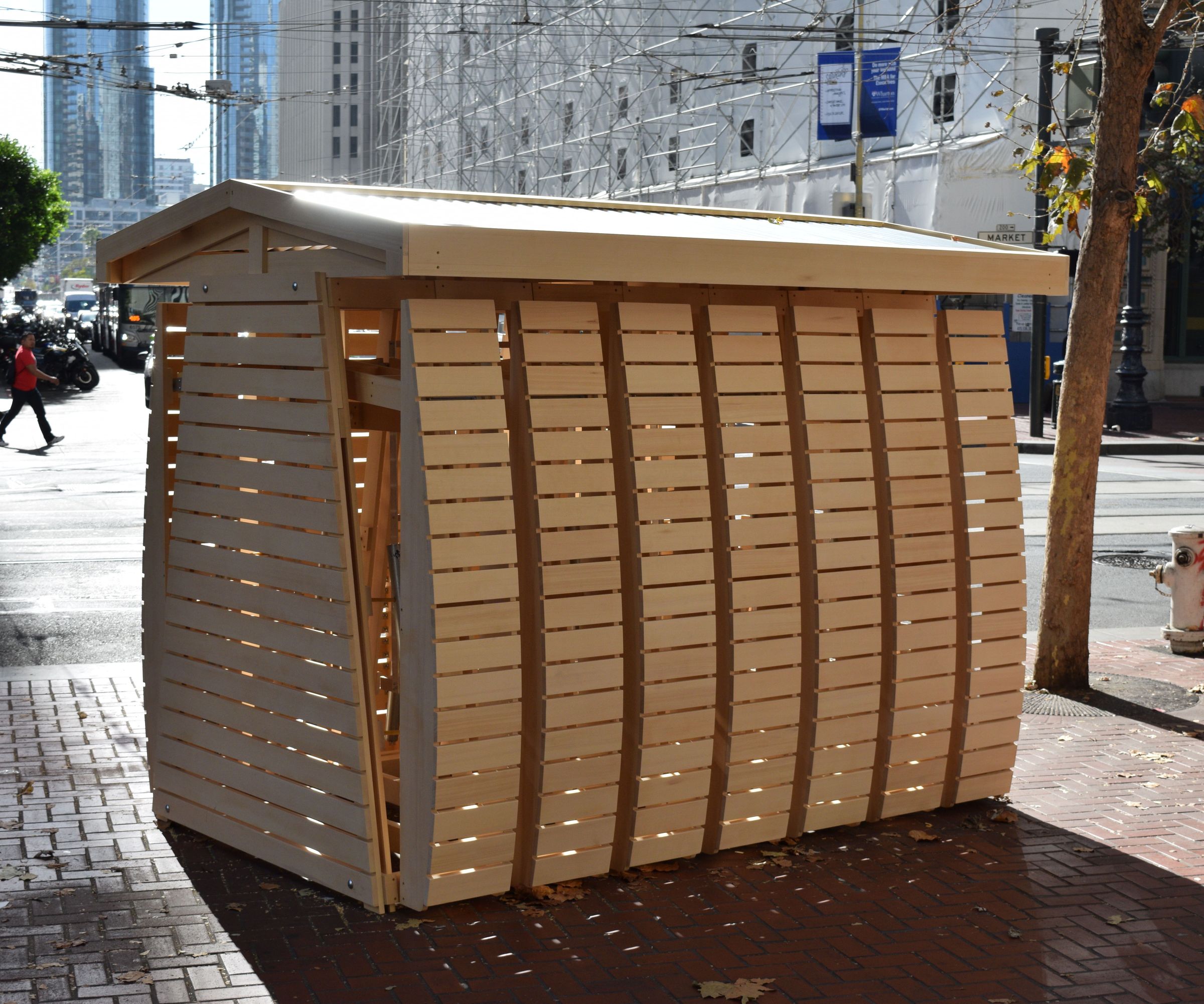

Step 11: Roofing
I decided to build a roof for the structure due to the unpredictability of the weather in San Francisco and because it just needed it. The top, like most other choices you could make with a thing like CHIME SF, could be absolutely anything.
Corrugated tin was my material of choice. It's clean, regular, repetitive curves are very pleasing to look at. The metal matched the chimes and the other pieces of hardware in the structure and it is easy to work with. I used the 5 degree cut from the body of CHIME SF again in the roof. Keeping consistent details like this really do a lot to tie a well composed form together.
Describing it with words is engineering prowess that I don't possess so I'll hope to convey the process with photographs instead. Basically 4 triangular trusses. Again, using 1" x 3" pine for the stock, build the frame and back it with all of the support you can give it. I assembled the roof off of the form and then lifted it on. Space the trusses evenly so they meet up with good points on the frame and attach runners along the length at the top, middle and base of the roof. Then you can measure out your tin, cut it and attach. The best way to do that is to use self-drilling roofing screws. Make sure you have accounted for overlapping the tin sheets for best fit and to avoid gaps in your roof..
I used the mounting flanges to connect the roof to the frame. They are very handy! Make sure you get both the right and the left versions. Four of these will suffice, as long as it's not windy and you really cinch them down.
