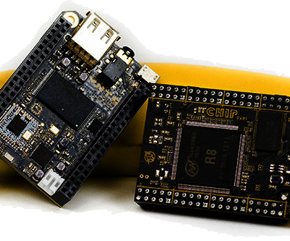

Step 1: The Bits
There are many ways to set this up. But this is instructables and the venerable Raspberry pi is my weapon of choice.
1. Mesh node: Linux computer w/wireless (rpi is a good place to start)
1. Some wifi adapters are not cooperative in ad hoc mode, I spent 3 days fighting with a pair of wifi modules that would do ad hoc, but would not broadcast. If you find you can't enable ad hoc, or you can't seem get ad hoc to behave. Check you settings then try a different adapter.
• Another Linux computer w/wireless (it takes two to network!)
• cjdns https://github.com/cjdelisle/cjdns
