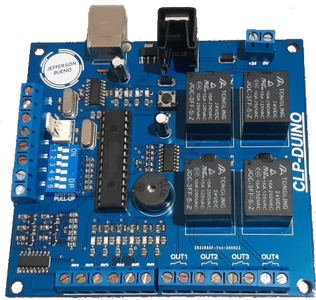

I created the CLP-DUINO with the aim of helping the learning in Ladder language with a low cost equipment and that can also be used in the automation industry. The design was based on the Atmega328P-PU but also compatible with the Atmega8-16PU.

The CLP-DUINO board has six 24Vdc digital inputs and four relay outputs on the board and a dedicated output for the buzzer where all must be pre-set in the software as shown in the image.
Step 3: USB Connection
For the usb connection I used the IC CH340G which does not require the use of the oscillator crystal. This makes it easy to program on the board without having to remove the MCU using the serial usb converter already present on the board via the type B usb connector
Step 4: Expansion of Inputs or Outputs
On the PLC-DUINO board we also have six more digital ports that can be counted as inputs or outputs.
Note: These digital ports are directly connected to the microcontroller
