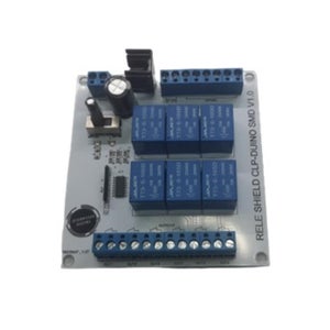

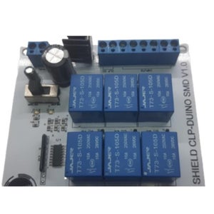

CLP-DUINO Shield Relay consists of an expansion board to complement the CLP-DUINO board circuit increasing six more relay outputs.
Step 1: Story
The article is being published in collaboration with JLCPCB. It is one of the most experienced PCB manufacturers with more than a decade in the field of PCB prototype and fabrication, they are committed to meeting the needs of our customers from different industries in terms of quality, delivery, cost-effectiveness and any other demanding requests.
Step 2: Connection
The connection of the Relay Shield must be made through wires in the digital ports of the CLP-DUINO following the silkscreen following point to point and configuring these outputs in the software increase six more outputs
Step 3: Supply Voltage
The supply voltage of the board can be performed using 5VDC directly from the CLP-DUINO board or through an external source, which can use from 6VDC to 24VDC maximum with a current of 1.5A.
Just change the selector switch on the board indicating if it will receive the CLP-DUINO source or external source
